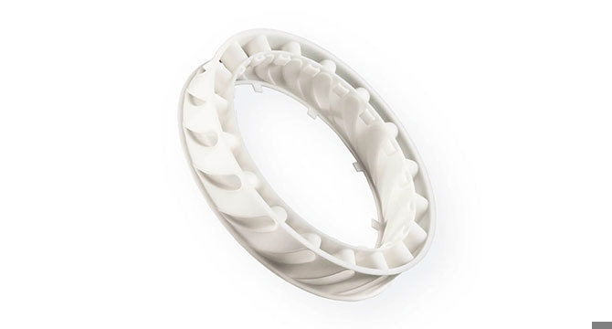

Accura Xtreme White 200 is an ABS-like, white material that is best suited for form-and-fit prototypes, snap-fit assemblies, consumer electronic components, and medical device prototypes.
![3D Printed ABS-like White (Accura Xtreme White 200) part](/media/dnnlhtby/accura-xtreme-white-200.jpg?width=670&height=360&rnd=133504758115570000)
What is Accura Xtreme White 200?
Accura Xtreme White 200 is a widely used, all-purpose material that provides flexibility relative to other SLA resins. It is an ideal stereolithography material for durability. Compared to the average value for injection-molded ABS, it will have a slightly higher tensile strength but lower elongation at break. Xtreme White 200's heat deflection is the lowest of all SLA materials.
