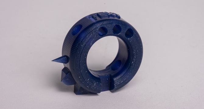

ABS-Like Value (N3D-MODEL333)
SLA Value is an ABS-like blue material designed for early-stage geometry development and rapid iteration.
What is ABS-Like Value (N3D-MODEL333)?
ABS-Like Value a high-throughput SLA resin optimized for early-stage iteration, delivering fast build speeds and reliable geometry validation before advancing to production-grade SLA materials.
