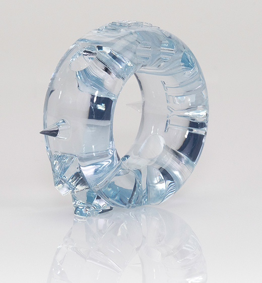

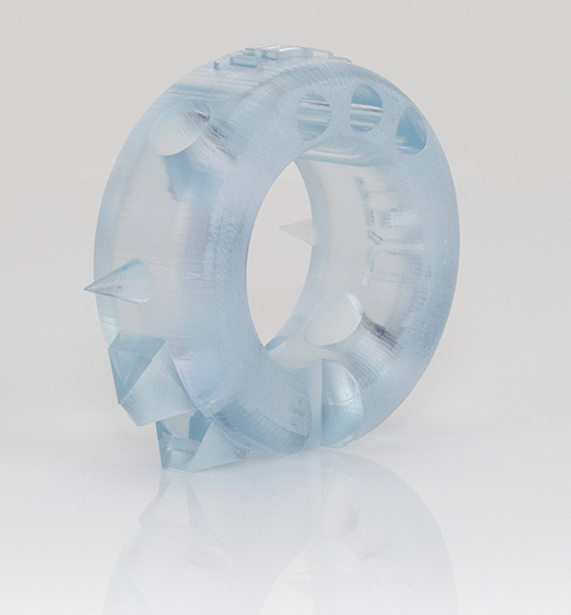

![Unfinished](/media/t53ixj3k/3dp_sf_520x560_sla_watershed_unfinished.jpg)
Unfinished
![Natural Finish](/media/1pkh5niv/3dp_sf_520x560_sla_watershed_natural.jpg)
Natural Finish
![Standard Finish](/media/anrnh3sm/3dp_sf_520x560_sla_watershed_standard.jpg)
Standard Finish
![Custom Finish](/media/0kfhhb4d/3dp_sf_520x560_sla_watershed_custom.jpg)
Custom Finish
