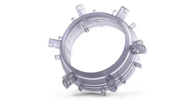

Accura 60 3D Printing Material for SLA
Accura 60 is a polycarbonate-like material that is ideal for parts with fine details and require translucence or high stiffness.
![3D Printed PC-like Translucent (Accura 60) Part](/media/ij0pvmbx/sla-quick-link-thumbnail.jpg?width=670&height=360&rnd=133511685271130000)
What is Accura 60?
Accura 60 is ideal for parts with fine details that require translucence and high stiffness. Custom finishing is required to achieve functional clarity. It has a high tensile strength and modulus, making it ideal for prototyping parts similar to molded polycarbonate. PC-Like Translucent is an ideal material for polycarbonate-like parts when thermal properties are not required.
