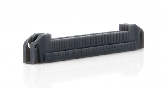

MicroFine Gray™ is an exclusive material developed at Protolabs in order to build small parts with ultrafine features.
When building a part with 3D printing, the machine’s resolution can have a significant impact on the final part by determining the minimum feature size, surface finish quality, and cost. To accommodate for a range of part geometries, we offer sterolithography (SLA) 3D printing in three resolutions: normal, high, and micro. Most parts can be built in normal resolution, but for parts with fine features around 0.005 in., high resolution may be required.
For the times when feature size is extremely small, such as 0.0025 in., we offer micro resolution. We can achieve these ultrafine features with our exclusive material, MicroFine™. This thermoset resin builds parts in 0.001 in. layers. The max. part size is 5 in. by 5 in. by 2.5 in., and offers extremely tight tolerances. Most parts built in MicroFine™ are no more than 1 in. by 1 in. by 1 in.
