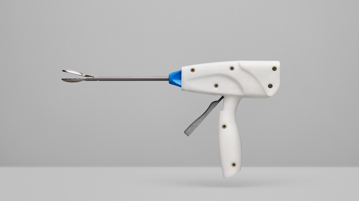

  • Surgical instruments: During surgery, doctors need instruments that feel steady, precise, and comfortable in their hands. 3D printing helps teams test new geometries faster and create instruments like forceps, clamps, and retractors that are tailored to a specific procedure or surgeon's preference.

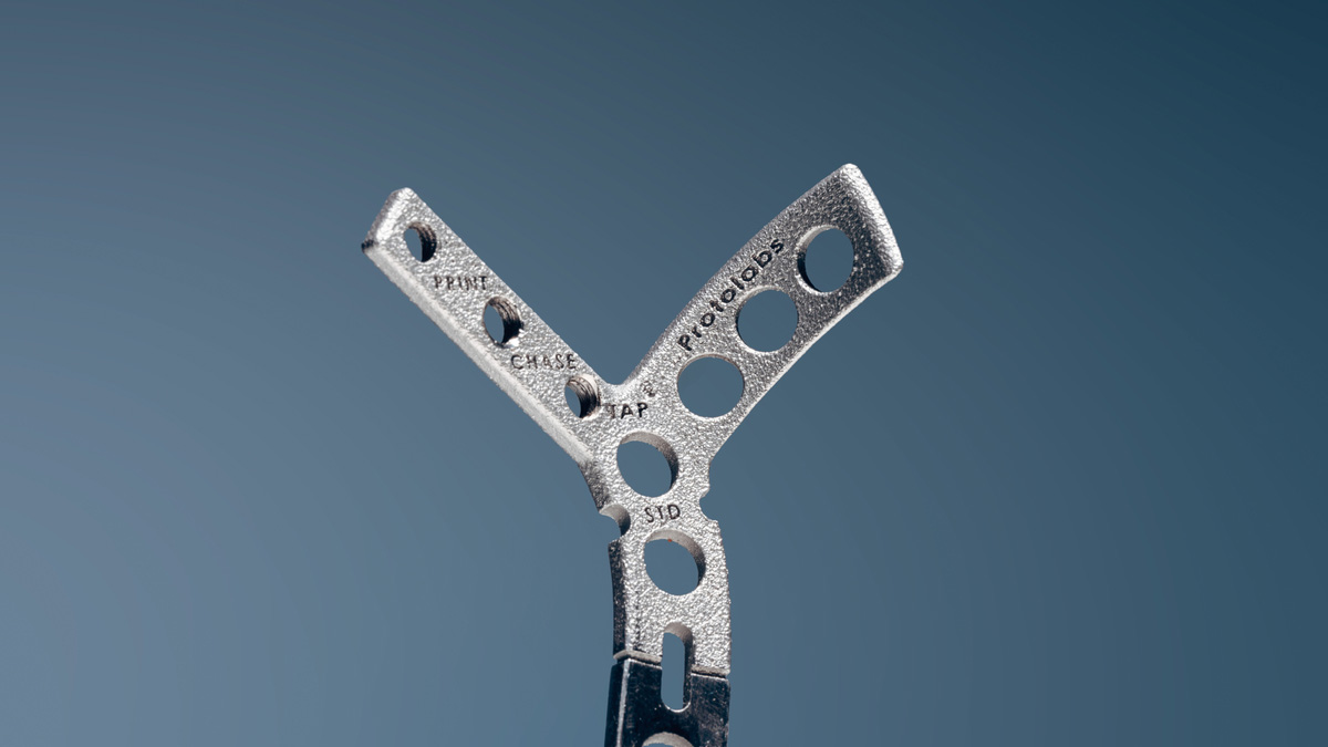

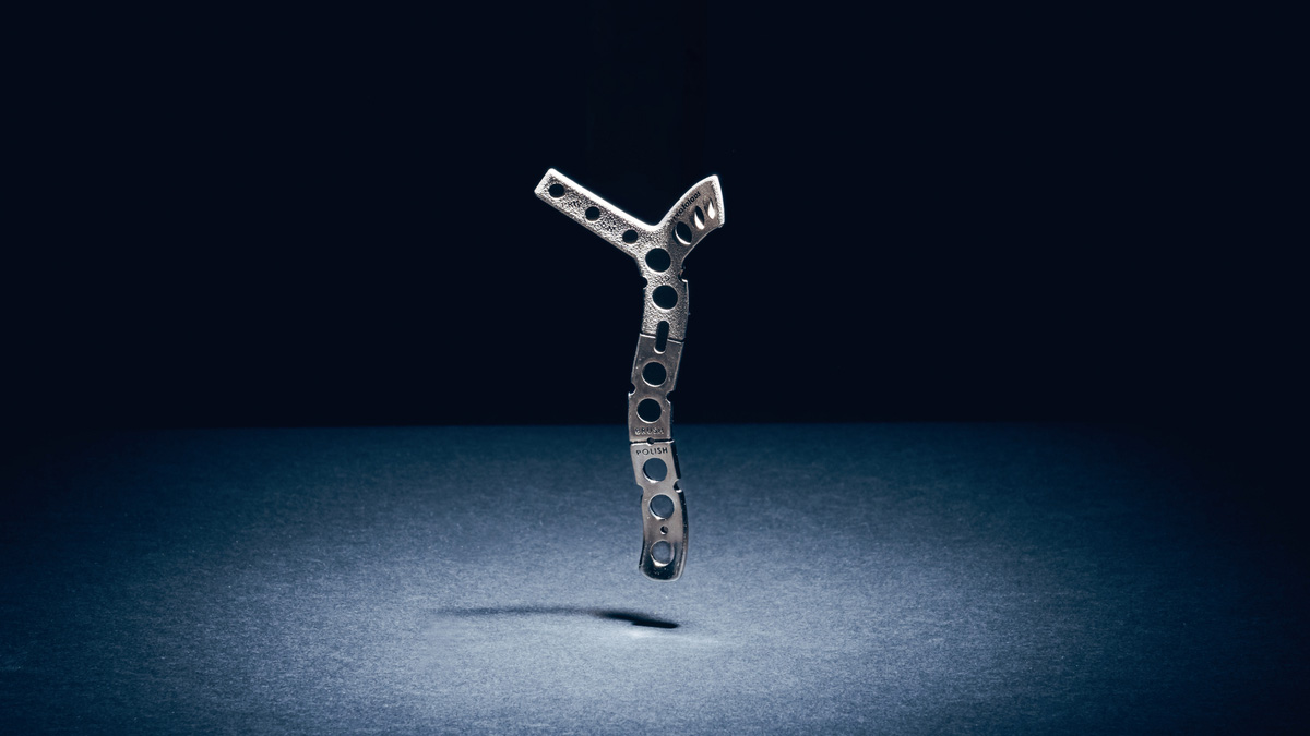

  • Advanced metal printing: Better metal printing and post-processing are facilitating lighter tools, more intricate geometries, and stronger custom components. Similar advances are also showing up in implants such as porous titanium structures that can support bone growth into the surface over time.
