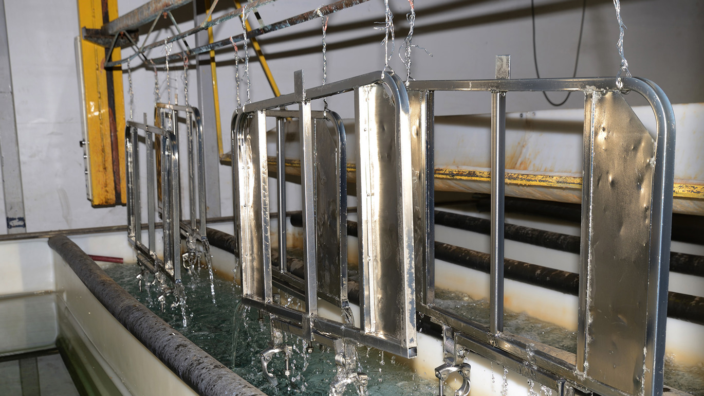

Electroplating process
Electroplating Process
