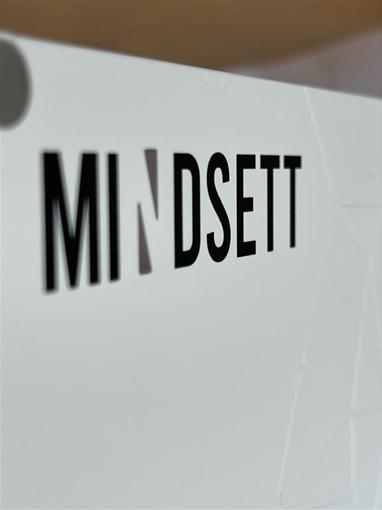

One of the final elements of the manufacturing process with Protolabs was industrial pad printing – a printing process that transfers a 2D image onto a 3D object by using a silicone pad to transfer the image onto virtually any shaped surface. In this project, adding the Mindsett logo to the casing of PRISM™.
“The file we’d created and provided for the logo was slightly offset from the embossed logo in the plastic casing part, but rather than demanding new files from us, Protolabs worked with us to resolve the issue. Tweaks they made themselves ensured accurate printing of the logo, saving us more valuable time in the process,” explains Ian.
