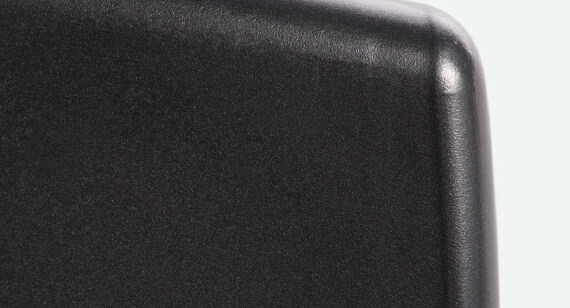

Plastic moulded part with knit line blemish
Figure 1: Knit line blemish in textured area. The lighter vertical elliptical area in the centre is textured visually differently than the surrounding area.
The cross-coupled nature of solving cosmetic issues is best shown by example.
Example: Knit lines
Refer to the photograph in Figure 1. This shows a section of a cover for a consumer device. The external side of the cover is textured with a medium bead blast. The mold designer chose to use two edge gates (located on the opposite non-cosmetic side of the part, not visible). The reasoning was the part would be hard to fill since it is fairly large and quite thin with a few thicker sections. Gate location was chosen to hide the gate vestiges.

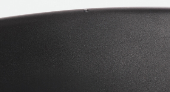

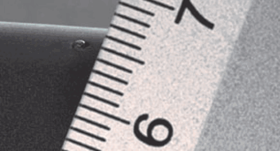

Hot tip gate vestige on plastic part
Figure 2: Hot Tip Gate Vestige. The vestige is the small bump on the top edge of the part where FDR is looking. Normally the bump is trimmed as flush as possible after moulding, but a vestige always remains.
The photo shows a knit line on the textured area. It has been lighted to accentuate the issue. The knit line itself (the vertical line in the middle) is visible in this lighting, but the biggest issue is with the texture. The cooler flow fronts of the resin aren’t forced into the mould surface texture as well as the hotter resin behind the flow front. Since the part is thin and cools quickly, the mould process tech can’t fill the part to achieve uniform texture appearance. This leaves a noticeable change in the appearance of the texture near the knit line.
There were several possibilities to mitigate the problem. A single edge gate would eliminate the knit line in this area, but the part would likely have had problems filling. The part could have been made thicker to make a single edge gate practical, though this adds weight and cost as well as the additional re-designing time and possible issues with mating parts. The gates could have been moved closer to the affected area so the cold area of the joining flow fronts might have been pushed away by the flow front, but this would have put edge gate vestiges in cosmetic areas.
Blushing around hot tip gate
Figure 3: Same area as is shown in Figure 1 after changing to one hot tip gate. The gate is on the top edge in the centre of this photo.
In this case, working with the applications engineer, the customer chose to use a hot tip gate in the centre of the part. A hot tip gate injects resin through the A-side of the mould directly into the part (i.e., without sprue or runners), leaving a small vestige (see Figure 2 for a close-up of the gate vestige). In addition, there is a slight blushing around the hot tip (barely visible in Figure 2, an area about twice the diameter of the dime, and Figure 3). Moving the gate was a tradeoff between having a hot-tip vestige (which was why a hot tip wasn’t tried first) and eliminating the knit line.

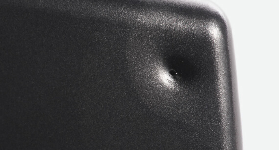

Sink on plastic moulded part
Figure 4: Sink. The centre of this sink mark is about 0.040” (1mm) below the design surface profile of the part.
Example: Sink
Another example of a problem with several potential solutions is shown in Figure 4. This shows a bad sink mark on a cosmetic part. Flipping the part over, we find the reason for the sink: a thin-walled part with a large solid boss (Figure 5). As the resin in the boss froze from the outside in, the core contracted and pulled from both ends of the boss. This left a significant cosmetic blemish that was not able to be processed out by the mould process tech. The material exacerbated the problem; the customer needed polycarbonate, which is extremely stiff (among the stiffest of all engineering resins), and is very prone to sink. The design guidelines for polycarbonate14 call for wall thickness of at least 1mm in small parts (and this is not a small part) and no more than 3.8mm in larger parts. The base of the boss exceeds the maximum thickness recommended for polycarbonate by quite a bit.

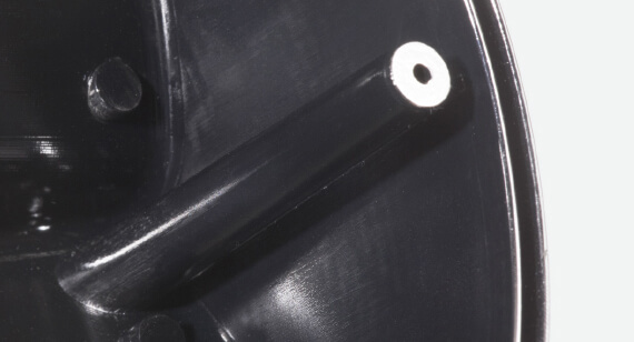

Boss causing sink on plastic part
Figure 5: The culprit. This 76mm tall boss has a base diameter of about 9.5mm. Because of internal and external draft requirements, the centre hole reaches less than halfway down the boss.
The ideal solution to this issue would be to core out the boss to its bottom, with a hole large enough to leave only a thin tube standing on the back side of the cosmetic surface (ideally the tube wall thickness would be 40–60% of the shell’s thickness15). This was not possible in this case due to the draft requirements on the inside and outside of the tube. Without draft on the outside, the boss would stick in the mould, typically breaking off in the mould during ejection. Without draft on the inside, the boss grabs onto the core pin, either breaking off the pin during ejection or distorting the part as it is pushed off the undrafted pin.

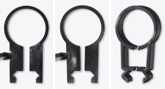

Three injection moulding designs of the same part
Figure 13: Acetal Part. (A) Optimised for minimum gate blush. (B) Optimised for minimum orange peel. (C) Redesigned to remove thick sections.
