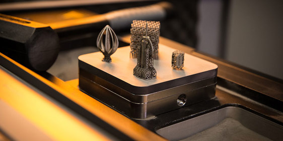

The key advantage to using additive manufacturing—specifically the 3D printing process called direct metal laser sintering (DMLS)—for prototyping is that it doesn’t require tooling. Metals are commonly used to prototype parts that will eventually be cast or metal injection-moulded. It can also be used for complex prototypes of parts that will be machined, specifically in harder materials such as titanium. In addition to saving the cost of tooling, metal printing also saves the time it takes to create production tools. In most cases, you can get a few printed metal parts far sooner than you could if they were cast.
metal prototyping with dmls 3d printing
Metal printing has similar surface finish, design considerations, materials, and tolerances compared to casting. Moreover, the prototypes made using DMLS are viable stand-ins for production parts.
The most notable limitation of printed metal prototyping is that material selection for DMLS is much smaller than that of other metal manufacturing processes. Materials are designed with the manufacturing process in mind, and additive manufacturing is not only relatively new, but also has unique material requirements compared to casting or machining. Therefore, the current material selection isn’t as broad.
We commonly see DMLS used for functional prototypes when it’s important to use a material as close to the production material as possible. This allows for testing attributes such as part strength or flow profile.
Since the surface roughness and tolerances of printed metals are comparable to cast parts, prototypes can be used to validate additional processing steps such as post-machining, vibratory finishing, or coatings. DMLS can also be used to prototype complex geometries that will eventually be machined from mechanically hard materials such as titanium or Inconel.

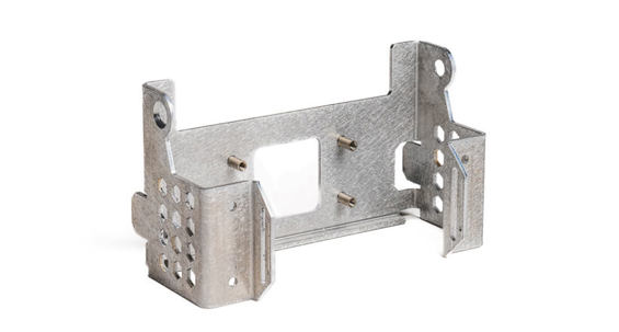

In Europe, we currently offer Sheet Metal Fabrication through our manufacturing network, Sheet metal stands alone in the pantheon of parts and designs as a technique which has stood the test of time and countless innovations. To this day, it has retained the artistry and craftsmanship of its foundational years. Two approaches to sheet metal design have dominated over the years. The first is a tangible approach that ultimately leads to a digital model. The second is a fully computer-aided design (CAD) that starts from, and lives in, the digital space.
metal prototyping with sheet metal
CAD isn’t available in every circumstance. Many engineers work with legacy equipment that predates 3D models and rendering. Sometimes, they don’t have the time to create the digital models necessary to design their parts. Situations like this call for the unchallenged master of sheet metal design: You can call it cardboard-aided design.
Cardboard can be an analogue to sheet metal for the design and development process. A resourceful engineer can find different kinds of cardboard with different stiffness characteristics and shapes, plus you can make your cardboard model as simple or as detailed as you want. This is a viable path to modelling and prototyping. There are distinct benefits to these physical models:
  • Having a part to hold helps you understand things like installation and tooling access.
  • It allows you to iterate to fix issues, such as clearance, as other parts of the assembly are developed.
  • Most businesses have waste cardboard, so materials are free.
A designer can take everything learned from the cardboard analogue and transfer dimensions and characteristics to CAD. From there, the designer is faced with making discrete decisions about things like material thickness, bend radius, and bend reliefs. There are questions of fabrication, such as whether your design requires welding. Plus, not everything you can make from cardboard—certainly not everything you make in CAD—can be produced in sheet metal with conventional tooling and equipment.
On the other hand, starting in the CAD environment, for all its benefits, has some distinct drawbacks. It is hard to get a sense of scale when a 25mm x 25mm) part takes up the same space on your screen as a huge part. Furthermore, the real world, even cardboard, has many more meaningful limitations than exist in a 3D-modeling environment.
One example is that a CAD package will allow you to drop a screw anywhere in a model. If you don’t take real world limitations seriously, you will design and produce an assembly that cannot be assembled because there is no way for a tool to access the fastener. You can model anything in CAD, but when working in cardboard you will quickly learn about the need for bend reliefs—cuts next to a bend that allow the material to form separately from the base flange. You will also learn that features can’t overlap in the flat; profile changes or welding will always be required but extruding four adjacent walls from a base is simple in a CAD platform.
Whether you start with a tangible analogue like cardboard or you’re a digital designer working exclusively in CAD spaces, there are a lot of fine details that can help you prototype sheet metal parts. Some of these you learn from working material or through iterations of design and prototyping, while others you learn from valuable, often automated design for manufacturability feedback, if your manufacturer offers it. These tips will take you far while you prototype your sheet metal parts:
  • Choose the tightest bend radius that suits your design. Tools do not necessarily align with material thickness. To best control cost and lead time choose either 0.762mm, 1.524mm, 2.286mm, or 3.048mm. Other standard sizes include 4.7752mm, 6.35mm, 9.525m), and 12.7mm.
  • Be ready for alternative fabrication methods. Sometimes we must weld flanges or split your part into a multi-piece assembly to achieve your design.
  • Remember that press brake forming has three points of contact; two spots on the bottom die and one on the top die. Because of this, it’s important to remember that a bend needs a flat region before and after the bend. Offsets are a special situation because, when space allows, they can be hit at once and not bent. If you need organic curves and complex forms, you will have to consider a stamping operation. Stamping is significantly different from conventional press brake forming.
There is a handy rule offering a guideline you can use in multiple situations: If you model your flanges or hole features at 4x material thickness away from the outside bend line, you will ensure formability and minimize or eliminate deformation due to hole proximity to the bend. Note this rule does not seamlessly apply to larger bend radii.
Following these rules in the prototyping phase can speed up your design and iteration time during prototyping for sheet metal parts.
