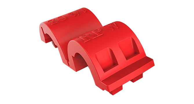

LDPE Injection Moulding Applications
LDPE is a flexible resin that is low cost, corrosion resistant, and durable. These properties makes it a good material choice for parts like:
- Enclosures
- Caps
- Snap fits
- Lids
