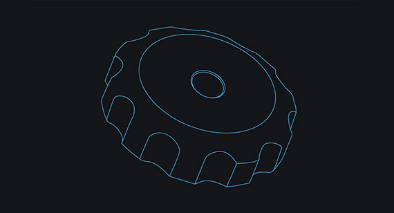

An integral component of the newly designed dispenser would be the adhesive air cap, which would be one of several parts eventually assembled into the adhesive dispenser. The applicator size and shape are intended to reach those small, hard-to-get-to areas of electronic products. “We tried to design this particular dispenser in a way to make it fit into tight areas where needed,” Chastine said. The adhesive dispenser air cap was a part that was to be molded but the engineers knew a few design iterations might be needed. Because of this, and the 10-12-week typical lead time for an injection mold, they needed to find a different solution.
Blue vector part

The team’s early design iterations called for the air cap to be injection-molded, but design issues emerged because of some required undercuts, Chastine recalled. Adding to the design challenge was the relatively small size of the air cap itself, which is 0.75 in. (19mm) tall, with the biggest diameter of the part being 2.3 in. (58mm).
As a result, the engineers considered using their own, in-house 3D printer, which has provided great design latitude, but their printer has a limited selection of printable materials.
“We needed a durable material, and we didn’t have it,” Chastine said. “Durability was a major requirement for this part because it would see some wear, and the part would also need to be threaded in one area as well.” When used, the cap needs to be turned clockwise to lock it in place and counterclockwise to remove the cap and replace the syringe of adhesive contained inside of the heated applicator. Air pressure is required for this applicator so the heated adhesive can be pushed toward the exit point of the applicator. The air pressure comes in through a fitting in the top of the printed cap.
