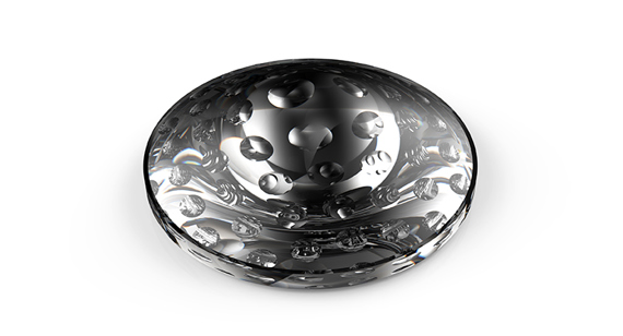

An optical part
This part was molded in polycarbonate with F1 finish on one mold half, F0 finish on the other and texture around the rim. (F1 has most cutter marks polished out.) The mold was designed with an unbalanced edge gate, and 3,400 pieces were produced with no significant issues.

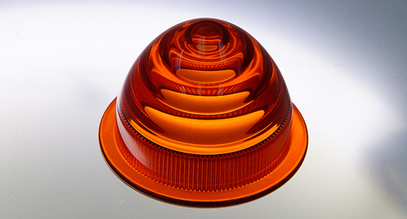

A polycarbonate optical part
This part was molded in polycarbonate with A2 finish on both mold halves. (This is the highest polish done by hand at Protolabs.) The part has uniform, nominal thickness of 0.108 in. and was molded in a run of 750 pieces with no issues.
