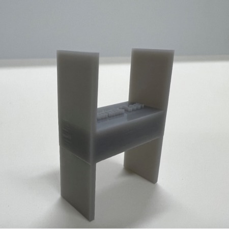

Differential shrink is present in a 3D-printed part that was oriented as shown above. The rapid transition from small to large cross-sectional area caused shrink on this part.
Orienting to Avoid Differential Shrink
In general, the more unequal distribution of material there is in a part, the more prone it is to fall victim to a phenomenon known as differential shrink. Certain part geometries and sizes are inherently more likely to shrink because they don’t include adequate support from the preceding layers of material. To illustrate this, think of a capital letter “H.” When the crossbar section appears layer-by-layer in the middle, it tends to pull the supporting legs inward, causing the part to bow near the bottom. To prevent differential shrink, there are a couple of options. Often, we build SLA parts on an angle to reduce the surface area, and thus the overall stress encountered for each layer. This also helps increase part dimensionality and tolerancing accuracy. In addition, we build parts lying down so that each layer formed is the same surface area as the layer beneath it, and there are no large cross-sectional swings. When dimension critical or high-resolution part features are required, we advise that parts are oriented to position those features on the up facing surface of the part. Keep in mind that building parts on an angle can result in parts with non-ideal surface finish if cosmetics are key.
3D Printed Parts
Differential shrink can be avoided by orienting to eliminate small to large cross-sectional changes on the part (shown above) or by orienting the part at an angle (shown right).

If it’s important for your part to have a cosmetic finish for use in a tradeshow or on display, we will tend to build the part flat and not at an angle. Any critical features should face up, as the top surfaces will be smooth and more prone to dimensional accuracy. On the other hand, if your part is built facing down, support structures that need to be removed and blasted would eliminate any glossy effect.
3D Printed Parts
The glossy effect is shown on the “H” that was built lying flat. The “H” built at an angle highlights layer lines and the visual effects they can have on text.
