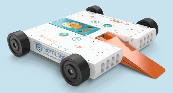

Every year in which he competes, DUCK! gets a bit of a new look, but also gets some upgrades to his exterior frame and insides. While DUCK! 1.0 was designed, built, and tested in 28 days, Rucker had a wealth of time for this season—a few years! Solid magnesium became the metal of choice for DUCK! 3.0’s chassis. The chassis cover, however, can be swapped out to meet weight regulations, using either polycarbonate, or even titanium. Also, for the first time, DUCK! used 3D-printed metal parts.
What can we look forward to with DUCK! this year? For one, he’ll be powered by more powerful brushless motors. They provide a lot of oomph, but it’s difficult to program a controller that allows for fine shifts in speed and forward/reverse direction.
Rucker tells us that this DUCK! iteration features multiple attachments that bolt onto the front and back of the chassis. This gives the bot a variety of extra armor pieces, or different types of forks.
On the offensive side, DUCK! has a stronger lifter mechanism (its beak) that works a lot like a regular duck’s bill. Most of those parts were built by us. Picking up and heaving a 250-pound bot that’s either spinning or trying to eviscerate you with a saw isn’t easy to do, but DUCK!, who sometimes seems to border on the masochistic, makes the attempt incredibly entertaining.
