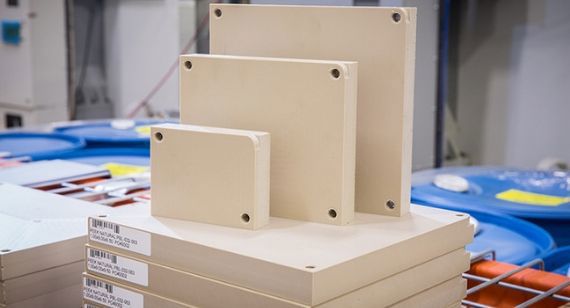

Ultem Material Block
Pictured above is a block of material of Ultem ready for machining. In some cases glass fiber is added to the material to further improve material properties.

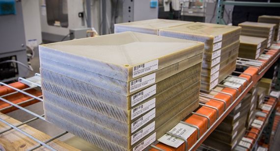

PEEK Material Block
PEEK is a high-performance plastic that is available for both machining and injection molding designs.
