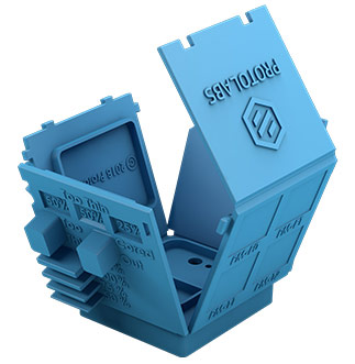

![Design Cube](/media/1023441/protolabs-blue-design-cube-landing-page.jpg)
Now that you've heard all about the Design Cube, grab one for yourself. It shows part features that are too thin or too thick, bad bosses, right and wrong ribs, and other considerations when designing parts for molding. Get a free Design Cube.
