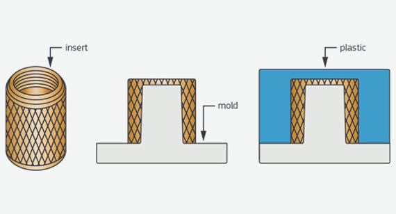

Like overmolding, insert molding injects a resin over another material, but instead of a plastic substrate the other material is typically metal and the injected plastic material is typically a rigid plastic. Metal electrical components or custom-machined metal parts are often embedded in plastic this way. Similarly, threaded inserts can be molded into plastic parts for stronger, more durable assembly of plastic components such as device shells. Insert molding is an alternative to inserting metal parts by either heat staking or ultrasonic welding, processes by which a molded plastic part is locally melted to allow the insertion of a metal part. Insert molding is more controllable and allows better encapsulation than the other methods. Molded in inserts also eliminate the need for a secondary insert installation process, saving time and money.
Because inserts are metal, they must be placed into a mold in which they will be encapsulated in plastic. This can be done robotically for high volume production, but for low- to mid-volume production insertion into the mold, pick-n-place is a manual process. There is no chemical bonding between metal inserts and plastic, so the insert and resin components must be designed for mechanical bonding.
Protolabs accepts pre-fabricated inserts, including PEM, Dodge, Tri-Star, Spirol and Tappex.
