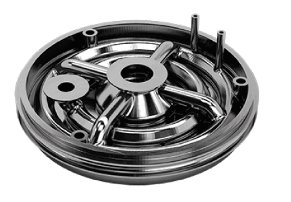

![metal 3d printed part with internal channels](/media/xcel1a1b/blog-v-day-3dp_interior-radii-1.png?width=573&height=398&rnd=132889562624230000)
