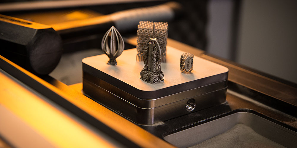

![DMLS Process](/media/phok3cpl/dmls-process-1.jpg)
DMLS starts with a metal powder that is melted in layers to form the part.
What is Metal 3D Printing? From Metal Powder to Liquid State to Finished Part
Direct metal laser sintering is really direct metal laser melting—DMLS is DMLM. That is, the sintering part of this additive process is really a melting process. We start with metal powder, then our machines use high-powered lasers to melt layers of that powder—to liquify it—to create complex 3D geometries directly from our customer’s CAD file. After a cross-section layer is created, the build platform lowers and a re-coater blade moves across the platform to deposit the next layer of powder into an inert build chamber. The process is repeated layer by layer until the build is complete. The main goal is to produce metallic parts with 100% density. More on density percentages later in the section on material strength.
