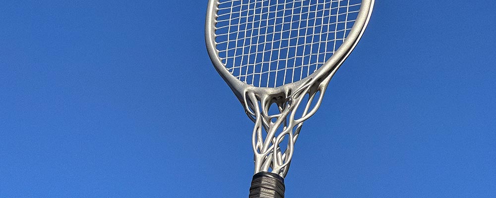

Tennis racket with blue background

Hìtëkw’s intricate curling branch-inspired design on the racket’s handle was initially conceptualized with the help of AI and generative design, but Lopez iterated different variations of it from there. “We wanted Hìtëkw to disrupt the imagery of the traditional tennis racket.”

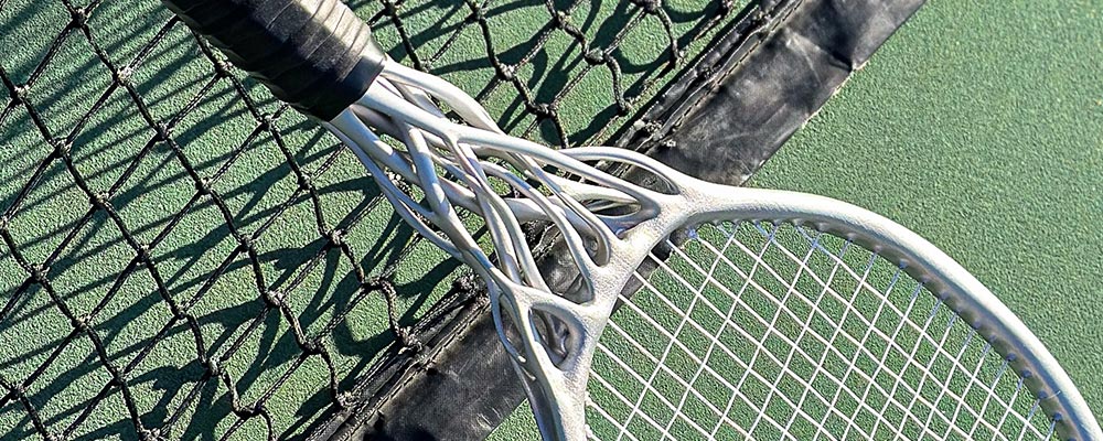

Tennis racket on a tennis court next to a net

Aside from aesthetics, practicality had to come into play for the concept. After all, someone would have to be able to easily hold and play with the tennis racket. The sheer concept and design of Hìtëkw was garnering a lot of media interest, so Lim and Lopez decided to turn to 3D printing to bring it into reality. “We wanted to be able to touch it and see if it would actually work and be functional,” said Lim.
As the idea was developing, it became clear that it would be nearly impossible to bring Hìtëkw to life via CNC machining or injection molding, due to the design’s intricate and complex nature. Protolabs’ metal 3D printing service became the clear technology of choice best suited to bring its organic geometry to life.

“This design is a great fit for additive because of the complexity and organic shapes; it would be very difficult to make this part using subtractive methods. You see similar design elements in lightweight components for automotive or aerospace where the design is intentional about adding material only where it’s absolutely needed and using branch-like shapes to get the best performance out the part,” Vollaro explained.
With a height of more than 26 inches, the Hìtëkw is on the larger end for a DMLS-printed part. Fortunately, Protolabs utilizes two GE Additive X Line capable of printing metal parts at a large scale in either aluminum in Inconel. The All Design Lab team opted for lightweight aluminum for a similar feel to today’s standard tennis racket.
