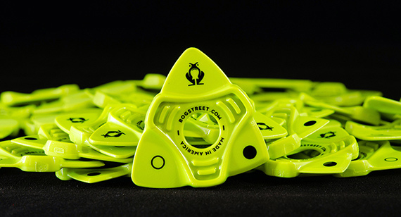

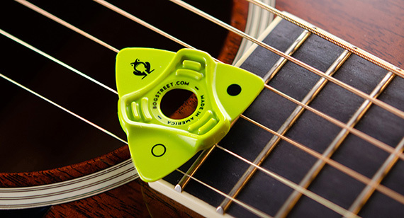

Well, Paul Holcomb, founder of Bog Street LLC and designer of the LEAP series of guitar picks, begs to differ. He has reimagined the guitar pick with an all-in-one design with variable thicknesses and a more ergonomic grip.
We spoke with Paul to learn more about how he developed this new design and the challenges he overcame taking the concept from initial prototype to molded production parts.
Paul Holcomb says he went through hundreds of prototypes and nearly a dozen iterations before landing on a final design that was ready for production.

With on-demand manufacturing, Holcomb has been able to manufacture thousands of guitar picks for retail.

We’ve done hundreds of prototypes and tooled up for low-volume production with on-demand manufacturing. We’ve manufactured thousands of parts for retail.

We are working on a smaller version with less aggressive grip area and other changes based on feedback from hundreds of customers. Our tools are cut and ready to manufacture at Protolabs, so hopefully we’ll be needing to place large orders in the near future. Plus, there will be a need for more 3D-printed prototypes when we work on the new design.
