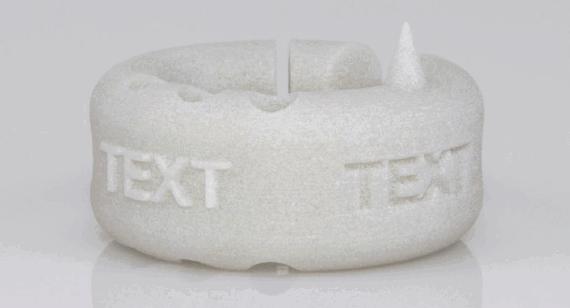

Smoothing Selective Laser Sintering (SLS) and Multi Jet Fusion Parts
Powder-based printing processes like SLS and MJF can leverage manual sanding for functional applications. However, we have found that sandpaper doesn’t quite smooth these surfaces to our level of scrutiny, even with high grit paper, especially if a paint application is required. The result can feel smoother, but the texture changes to more of a velvet-like surface. It’s not a 1:1 comparison to the way SLA parts sand. Truly smoothing these materials is best achieved using machining.
Nylon and TPU parts also rely on additional techniques such as chemical or vapor smoothing to essentially melt the surface into a uniform texture. This method is becoming more widespread. We always dye our MJF parts black to create a uniform aesthetic appearance. If you want a smoothly painted SLS or MJF part, it’s best to start with a heavy layer of primer to seal the material. The primer can be smoothed out before paint application occurs.
