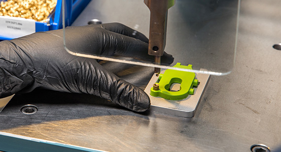

Applications for threaded inserts in injection-molded parts abound. They are common features that show up in a range of industries and in a variety of parts—housings, casings, electronic enclosures, appliance knobs and dials, etc. The two methods we use at Protolabs for threaded inserts, if insert molding is not an option for your design, are heat staking and ultrasonic welding, injection molding processes by which a molded thermoplastic part is locally melted to allow the insertion of another part. Both options offer tightness, durability, and aesthetics for plastic parts.
![Threaded Inserts](/media/1018138/heatstakeinserts_tv_3749-570x308.jpg?width=570&height=308&rnd=132114795847100000)
Heat staking is the process of heating threaded inserts and press fitting those inserts into part geometries, an application that relies on precise control and application of the temperature and pressure to cause the reforming of the plastic. Heat staking is commonly used in the manufacturing of appliances, automotive parts, and components and equipment for the telecom industry.
Ultrasonic welding is typically used for plastics. The process deploys high frequency ultrasonic acoustic vibrations in a localized area to press fit inserts into part geometries, creating a solid-state weld. You’ll see this process used for parts in medical devices, automotive parts, aerospace components, and electronic assemblies. We stock and install an assortment of commonly used standard inserts in UNF and metric sizes. Please note that we are currently unable to accept user-supplied custom inserts.
