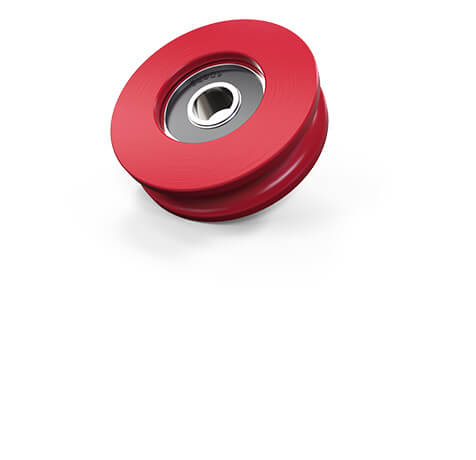

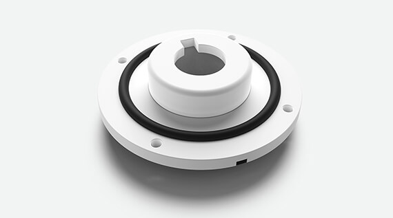

Insert Molding Capabilities
Instead of a mold that produces a final part using two separate shots like overmolding, insert molding generally consists of a preformed part—often metal—that is loaded into a mold, where it is then overmolded with plastic to create a part with improved functional or mechanical properties. We currently accept inserts from PEM, Dodge, Tri-Star, Spirol, and Tappex. A complete chart of stocked inserts at Protolabs is available here.
One way insert molding is used is with threaded inserts, which reinforce the mechanical properties of plastic parts’ ability to be fastened together, especially over repeated assembly. Bushings and sleeves are another great way to increase part durability for mating components that need more abrasion resistance due to moving parts.

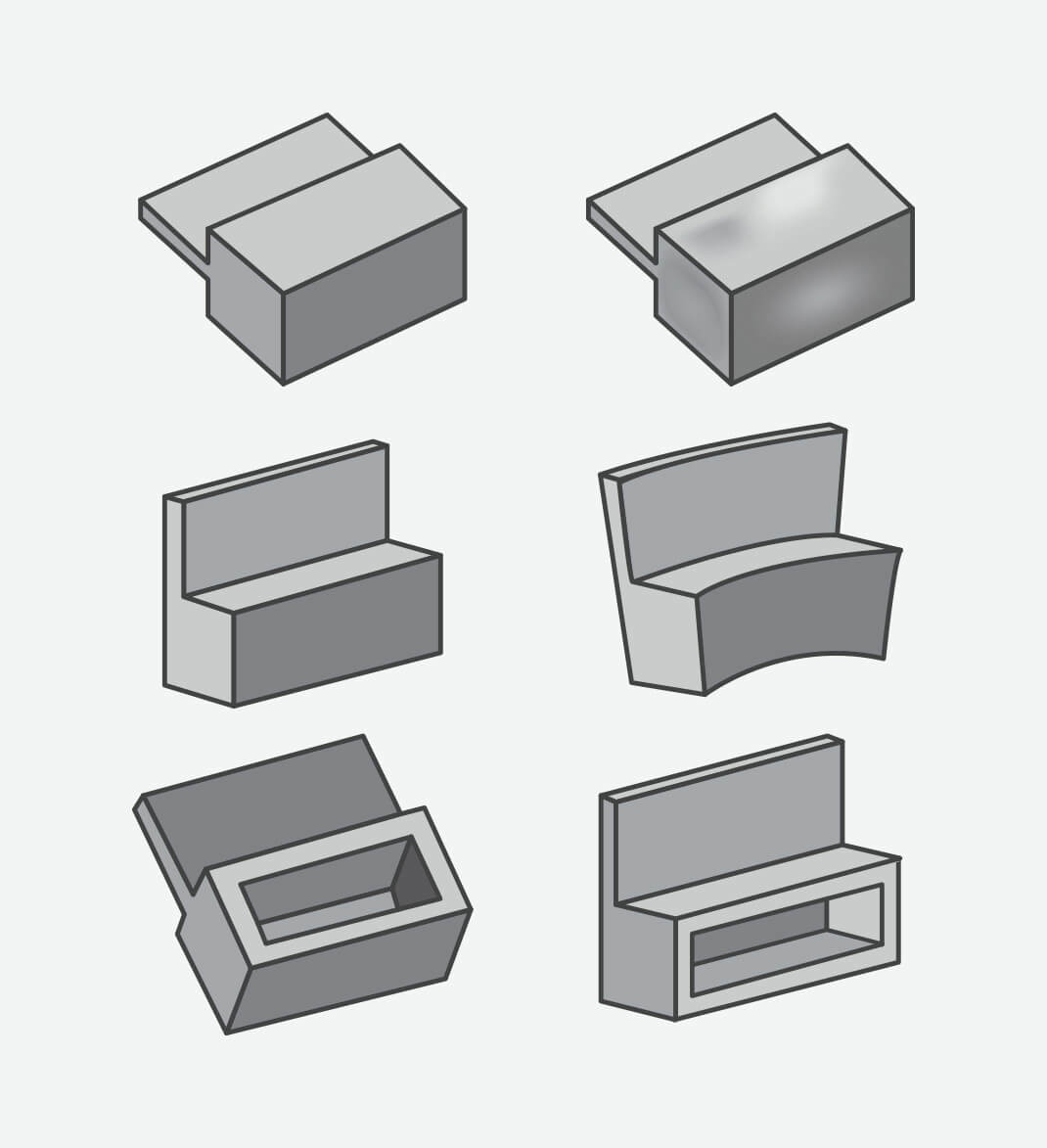

Wall Thickness
MATERIAL | RECOMMENDED WALL THICKNESS |
ABS | 0.045 in. - 0.140 in. |
Acetal | 0.030 in. - 0.120 in. |
Acrylic | 0.025 in. - 0.500 in. |
Liquid Crystal Polymer | 0.030 in. - 0.120 in. |
Long-Fiber Reinforced Plastics | 0.075 in. - 1.000 in. |
Nylon | 0.030 in. - 0.115 in. |
Polycarbonate | 0.040 in. - 0.150 in. |
Polyester | 0.025 in. - 0.125 in. |
Polyethylene | 0.030 in. - 0.200 in. |
Polyphenylene Sulfide | 0.020 in. - 0.180 in. |
Polypropylene | 0.035 in. - 0.150 in. |
Polystynene | 0.035 in. - 0.150 in. |
Polyurethane | 0.080 in. - 0.750 in. |
* The table is adapted from manufacturingcenter.com.
MATERIAL |
ABS | 1.143mm - 3.556mm |
Acetal | 0.762mm - 3.048mm |
Acrylic | 0.635mm - 12.7mm |
Liquid Crystal Polymer | 0.762mm - 3.048mm |
Long-Fiber Reinforced Plastics | 1.905mm - 25.4mm |
Nylon | 0.762mm - 2.921mm |
Polycarbonate | 1.1016mm - 3.81mm |
Polyester | 0.635mm - 3.175mm |
Polyethylene | 0.0762mm - 5.08mm |
Polyphenylene Sulfide | 0.508mm - 4.572mm |
Polypropylene | 0.635mm - 3.81mm |
Polystynene | 0.89mm - 3.81mm |
Polyurethane | 2.032mm - 19.05mm |
![The top row represents a part designed with thick features and the resulting sink once molded. The middle row also shows a part designed with thick features, but this time the warp that occurs once molded. The bottom row demonstrates how coring out thick features helps create an optimally molded part.](/media/1012940/om-dg-wall-thickness-tiny.jpg)

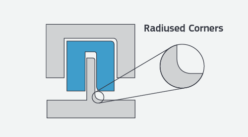

Radii
Some part corners will have a radius rather than a sharp edge since we use an automated CNC milling process to make the mold for your parts. This typically does not require a change to your model, but resulting radii are identified before the mold is milled.
