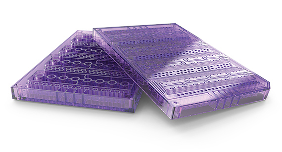

Microfluidics fluid handling part
VALOX’s strong chemical and heat resistance makes it an ideal option for automotive and medical applications such as oil and gas or fluid handling like this microfluidics part.
