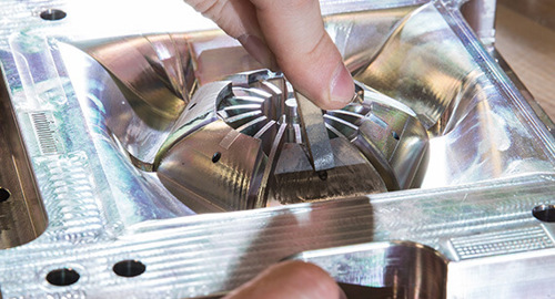

What is Injection Molding?
Injection molding is a manufacturing process for producing finished parts from plastic, elastomeric, or other moldable materials. In plastic injection molding, resin is melted, injected into a metal mold cavity, cooled, and ejected as a solid part.
The process is widely used for plastic parts because it can produce consistent results with low material waste and low cost per part. You'll find injection-molded components across industries such as medical devices, aerospace, automotive, robotics, consumer electronics, and industrial equipment.
Depending on where a part is in development, Protolabs can support prototyping, production injection molding, and on-demand production with no minimum order quantity. Parts can be delivered as fast as one day, depending on the project. Its plastic injection molding capabilities support parts up to 18.9 in. by 29.6 in. by 8 in. (480mm by 751mm by 203mm). For more detail on draft, radii, wall thickness, and moldability analysis, see Protolabs’ guide to injection molding basics.
How Does Injection Molding Work?
Injection molding works in two stages: making the mold and producing the parts. First, a mold is designed and manufactured around the part geometry. The mold includes the cavity that forms the part, along with gates, runners, cooling channels, ejector pins, and any features needed to release the part.
Once the mold is ready, the molding cycle follows a sequence: clamp the mold, inject molten resin, cool the part, eject it, and repeat. Even in this simple cycle, small design choices can affect fill, cooling, shrink, cosmetics, and repeatability. Protolabs’ aluminum mold tooling options can support different stages of development, from early validation through production.
