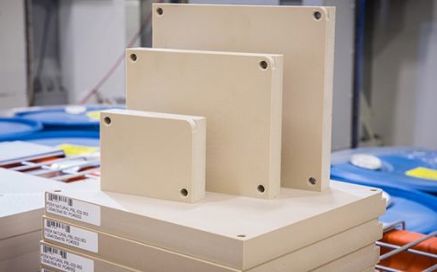

PEEK, or poly ether ketone, is a high performance thermoplastic with excellent strength and ductility. It's also FDA compliant for food contact and can be sterilized for medical applications.
Key benefits
- Good strength and stiffness
- High ductility
- Chemically resistant
- Food safe
