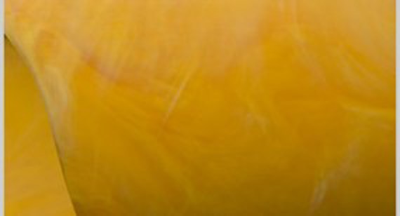

Sample of swirling effect from a nylon material with yellow colorant.
Sample of swirling effect from a nylon material with yellow colorant. Choosing a pre-compounded resin would have helped the customer avoid this issue.

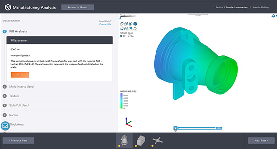

Part shown in on screen workspace
Protolabs’ design for manufacturing (DFM) analysis automatically highlights thin and thick areas in your CAD model, which can help initiate discussions on ways to ensure consistent flow through the mold.

Because some parts can’t have the same thickness throughout, gradual—rather than drastic—changes between thick- and thin-walled areas will help avoid differences in material flow that can cause flow lines. Protolabs’ design for manufacturing (DFM) analysis automatically highlights thin and thick areas in your CAD model, which can serve to initiate discussions on ways to decrease those variances.

Colored resin
Smooth mixing of custom colorants is also important to avoid flow lines in molded parts.

Expert molding team members can process out flow lines and other issues before producing customer parts from a new mold. Operators can adjust several parameters on the device to reduce flow lines. Those include increasing the injection speed of the material going into the part, raising the temperature of the material, or turning up the fill pressure. Before your resin hits the mold, Protolabs’ digital mold flow simulation can identify when changing the thickness of a part or the type of plastic used would improve material flow in the mold and allow production at safe pressure levels.
