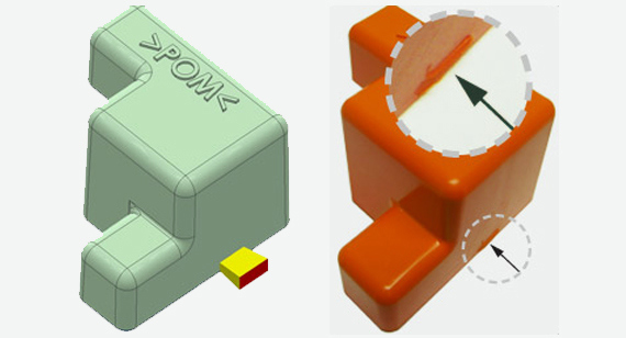

Tab gate illustration
Figure 1: The yellow block in the image on the left is the size and shape of the tab gate. The tab gate can be moved to different locations on the part with limited restrictions. The molded part, on the right, shows a rectangular blemish at the gate location.
Tab Gates
The tab gate is the most commonly used of the three types. It consists of a trapezoidal block milled into the parting line on an exterior surface of the part (see Figure 1), and is usually placed in a thicker wall section rather than thinner areas. Its position usually makes it easy to trim off, and while it typically leaves the largest vestige of the three gate types, its position at the parting line affects only the edge of the part, where it usually does not interfere with function or cosmetics.
The tab gate is easy to manufacture, maintain, and process, and there is typically a great deal of latitude in its placement along the parting line. Its design helps confine stress generated during ejection to the tab, which is trimmed off after molding. Also, being relatively large, it is ideal for use with filled resins, which can be difficult to inject through smaller gates. For all these reasons the tab gate is the first choice among gates.

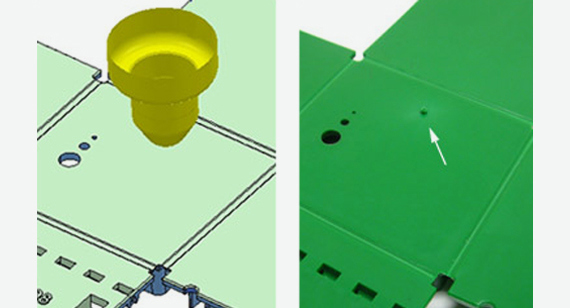

Hot tip gate location
Figure 2: The yellow cylinder represents the gate location, as shown in an order confirmation. The result is a small raised bump on the surface of the finished part which can be trimmed by hand.
Hot Tip Gates
The hot tip gate is positioned near the center of a part rather than at the edge. This reduces the distance resin must travel to fill the mold and helps center the clamping force the press applies to the mold. Figure 2 shows an image from a sample Protolabs order confirmation with a hot tip gate location. The yellow cylinder is a cavity milled into the A-side mold half to which a single-drop hot tip will be bolted. Hot tip gates are always on the A-side.
The hot tip gate is often used on round or domed parts to achieve radial flow rather than the linear flow of a tab gate. Also, because this gate takes up no space at the edge of the mold cavity, it can be used on parts approaching Proto Lab’s maximum part footprint size. The gate leaves a small raised bump, typically 0.060 to 0.080 in. in diameter and 0.010 to 0.020 in. high, that can be trimmed flush to 0.005 in. proud. Depending on part geometry and resin type, a hot tip gate can also leave “blush” or flow marks in a circular pattern around the gate site. These can be problematic because they are typically on the cosmetic surface of the part. Another problem is the potential for degrading resin in small shot sizes. And finally, because it is a small gate, a hot tip can become plugged if used to inject resins with high glass fill content.

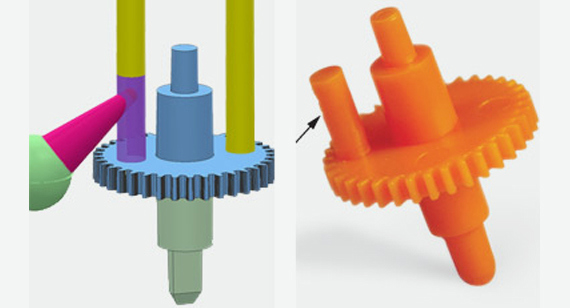

Plastic part with pin gate
Figure 3: This gear is an excellent example of a part that used a pin gate. The final part, on the right, shows the post from the tunnel gate, which is removed in a manual process.
Pin Gates
The pin gate is the least common of the three gates. It is typically used for complex parts that cannot have gate vestiges on the edges where tab gates would be or on the cosmetic side of the part where hot tip gates are located. It is the only one of the three gate types that is located on the B-side of the mold, typically the non-cosmetic surface.
Instead of introducing resin into the mold cavity where the part is formed, a pin gate injects resin into the ejector pin channel (see Figure 3). The ejector pin, shown in yellow below, is shortened, and resin is injected from the cone-shaped “tunnel” gate through the empty section of the ejector pin channel, shown in purple, and into the mold to form the part. Once the resin has hardened, the ejector pin pushes against the cylindrical post in the pin channel to eject the part from the B-side mold half. The ejector pin shears the post from the tunnel gate, leaving the post rising from the surface of the ejected part. The post is later removed in a manual process. Because it injects resin through an ejector pin hole, this gate creates a vestige on the finished part like an ejector pin but trimmed flush to 0.005 in. proud instead of the standard ejector pin that is flush to 0.005 in. recessed into the part.
The use of the pin gate is geometry-dependent, and while it can produce excellent results, it can be challenging to process. The cone-shaped tunnel gate precludes the use of many glass-filled resins, and the shearing of the cone from the post during ejection can place significant stress on the mold. Finally, the angle and depth of the cone rules out its use with many geometries, such as housings or other cored-out parts.
