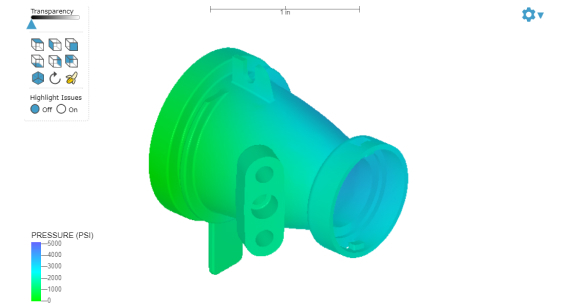

Figure 1: Flow analysis helps determine gate placement, locate knit lines, and identify where gas trappings can occur.

The analysis also examines how resins flow with certain temperatures and injection pressures (Figure 2). As material cools it begins to harden which is why gate pressure increases. The higher the pressure, the more difficult the fill, which translates to greater concern about weak knit lines (contributing to poor part integrity), flash, sink, and shorts.
