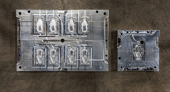

2. Mold Base Size
Our second cost driver is the base size of the mold. This is a common point of confusion in the manufacturing process, as it isn’t always evident how large or small the mold base is. For example, a 1 in. x 1 in. (25.4mm x 25.4mm) part in a straight pull mold might be able to be made in a 4 in. x 4 in. (101.6mm x 101.6mm) mold base. Add an undercut to that part, requiring a side action cam in the mold, and suddenly you might be into a 10 in. x 10 in. (254mm x 254mm) mold base or larger. In this case, base size and componentry drive mold cost. A single side action might add $1,500+ to the mold cost, so design best practices like pass-thru cores to help you save big on space and components!
3. Internal Componentry
We touched on this in numbers 1 and 2, but outside of poor design and mold size, internal componentry is the key cost driver in an injection mold. What types of internal componentry? As we previously discussed, side actions cams are an obvious example in this department. Some other examples of internal componentry could be: pick-out inserts, bolt-in inserts, or steel core pins. Cams or inserts will typically increase your overall mold price by $1,000-2,000 per component, so keep that in mind while you’re designing.

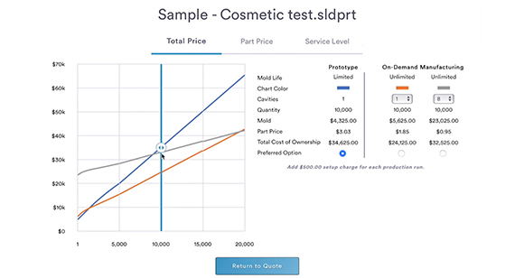

4. Polish or Custom Finishing
Our last cost driver is polish or custom finishing. Most manufacturers will offer a range of finishes to choose from on your parts, like in-house, SPI, or Mold-Tech equivalent finishes. We offer all three of these categories, and all have varying degrees of cost increases associated with them. In-house finishes will usually be the cheapest and are sometimes automated or as-milled. These are great for prototype parts to test fit/form/function but might not carry the aesthetic properties needed for a production part. SPI or Mold-Tech equivalent finishes tend to be the expensive ones, so you can save time and cost by waiting to put these cosmetic finishes on the mold until after your design is finalized.
