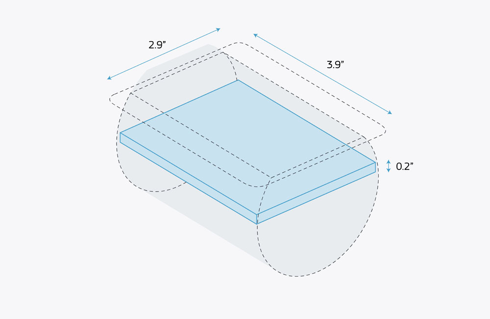

![Part Illustration](/media/3ygnxa1b/77_cnc_6-ways-to-optimize-part-design_fig-1.jpg)
This design tip explores several CNC machining capabilities, including 5-axis machining, as shown here. This illustrates the largest part extents maximizing the raw stock of material for a part width of 2.9 in. and 0.2 in. in height.

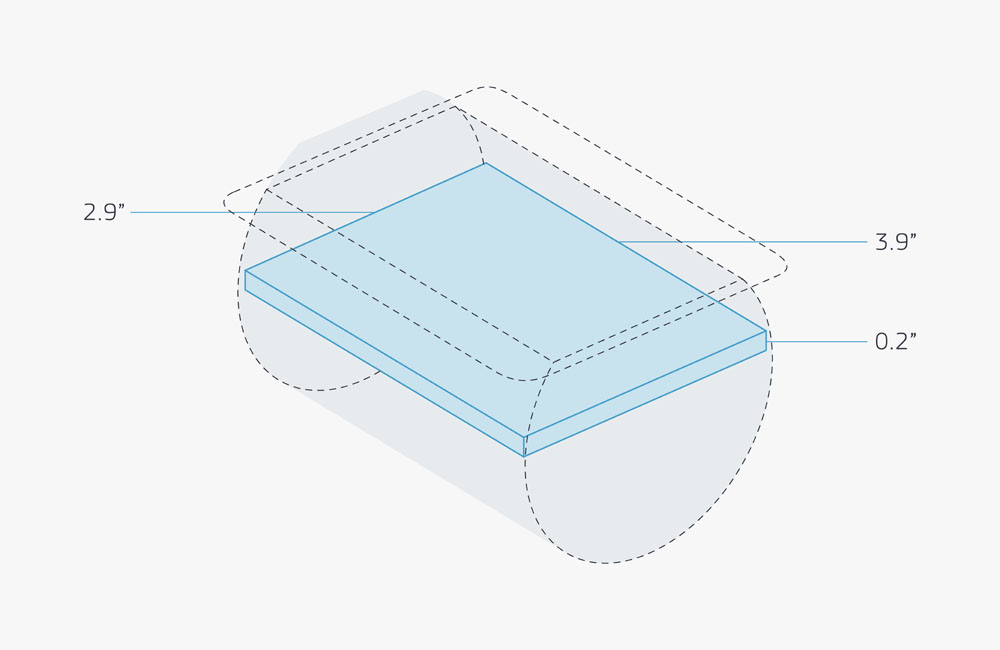

Two distinct “flavors” of milling exist at Protolabs. With 3-axis machining, the workpiece is gripped from the bottom of the raw material blank while all of the part features are cut from up to 6 orthogonal sides. With parts larger than 10 in. by 7 in. (254mm by 178mm), only the top and bottom can be machined: no side setups! With 5-axis indexed milling, however, machining from any number of non-orthogonal sides is possible.
The toolsets used in either case are identical. What’s different is the raw material. As with our lathes, round stock is used for 5-axis milled parts, which presents some interesting mathematical discussions about the size, geometry, and positioning of the part within that raw material volume (it’s that whole Pythagorean theorem thing you learned in high school). For some examples of this, you can stare at the accompanying diagrams for a while, or just upload your part model online at protolabs.com.

![Part Illustration](/media/dkrlgg5q/77_cnc_6-ways-to-optimize-part-design_fig-1_klb.jpg)
For a part using 5-axis machining, this illustrates how the part fits within a block of material using maximum part extents of 2 in. width and 2 in. height.
