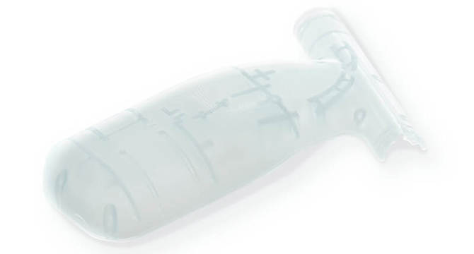

Somos 9120 is translucent in appearance and is our most flexible stereolithography material available.
![3D Printed PP-like Translucent White (Somos 9120) Part](/media/n3clgke5/3dp-materials-tool_images_pp-like-translucent-white-somos-9120.jpg?width=670&height=360&rnd=133318977762400000)
What is Somos 9120 Material?
Somos 9120 is translucent in appearance. It’s also the most flexible stereolithography material available with a flexural modulus of 1,600 MPa. Its mechanical properties are similar to the average values of injection-molded polypropylene except for a
slightly lower elongation at break.
Applications
PP-Like Translucent is often used for medical device prototypes, electrical casings, fluid flow analysis parts, and automotive components.
