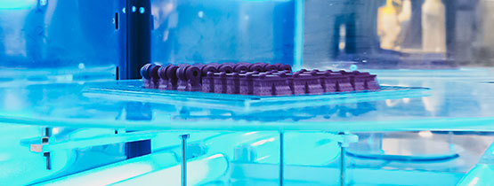

![sla parts](/media/hfwdvb2o/sla-process.jpg?width=555&height=210&rnd=133522994175900000)

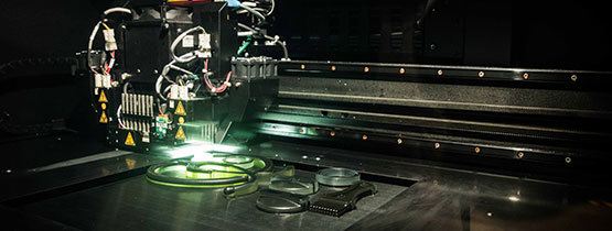

![polyjet 3d printing in process](/media/qnyj3nzi/polyjet-process.jpg?width=555&height=210&rnd=133522994167970000)

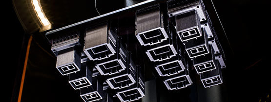

![](/media/rgcht3jh/carbon-process.jpg?width=555&height=210&rnd=133522994150830000)

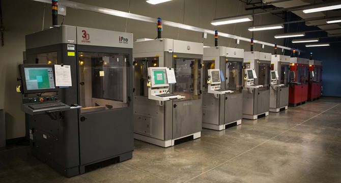

Our Resin 3D Printers
Our 3D printing facility houses a variety of resin 3D printers to support various material options, build volumes, and resolutions (normal, high, and micro).
Stereolithography: 3D Systems Viper, ProJet 6000s, ProJet 7000, iPro8000, and ProX 800s
PolyJet: Objet260, Connex3, Objet350, and Objet500 Connex3
Carbon: M2
