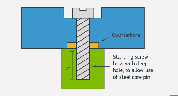

For bosses with relatively deep holes, the counterbore should be placed on the other part to allow for the use of a steel core pin.
Counterbore Design
Since screws are going into a hole without threads, plastic will be displaced as you thread the screw into the boss. This is when a counterbore comes in handy. A counterbore is additional space designed into the part to accommodate this excess material.
In some cases, a design requires a relatively deep hole, like 1.5 in. deep with an 1/8 in. hole diameter, for example. Due to our rapid injection molding process, we use steel core pins to produce these types of holes rather than coring them out with the b-side of the mold. This makes it difficult to have a counterbore on the part. But don’t worry, there is a solution, and it’s a simple. A common workaround is to place the counterbore on the opposite part, the one that the screw will be running through completely.

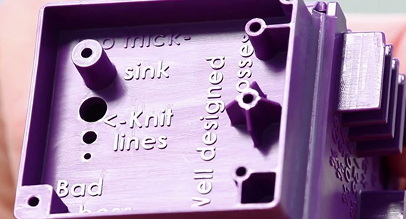

Cosmetics. If cosmetics are a concern, avoid thick sections that will be susceptible to sink. One common problem area is bosses located on or near exterior walls, we recommend moving these inwards. In addition, as a rule of thumb, we advise no more than 60 – 70 percent of the adjacent wall thickness for bosses.
molded boss on design cube
The Design Cube demonstrates several boss designs, both good and bad, including how to use ribs and gussets to reinforce connection points.
Strength. Screw bosses can be reinforced with ribs or gussets for added strength and durability. As we mentioned above, a boss should not be next to exterior walls, but you can use coring ribs to keep it connected to the part’s exterior wall without risking sink.
