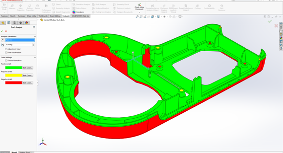

Draft Analysis Tool in SOLIDWORKS
SOLIDWORKS highlights positive draft in green, faces requiring draft in yellow, and negative draft in red
Draft Analysis
The first thing you want to check for is draft. Without that, parts are not going to eject from the mold cleanly and easily. The molding process is typically engineered around speed and volume so the easier the parts come out, the faster they can be produced and the less chance those parts will incur any cosmetic defects.
To run the Draft Analysis tool in SOLIDWORKS, you will find it on the Evaluate tab of the CommandManager, or if you want to go another route, it can also be found under the drop-down menus in View > Display > Draft Analysis.
When you run it, you need to tell SOLIDWORKS the direction of pull and what angle of draft you want to look for as acceptable. In most situations, 2 degrees is the amount to look for. For shut offs or if there is a texture required on the face, you should apply at least 3 degrees.
SOLIDWORKS will then highlight positive draft in green, faces requiring draft in yellow, and negative draft in red (assuming they are all set to default colors). When viewing the part from both sides of the direction of pull, it should be all green from one side and all red from the other. Any yellow faces, need draft added.
For extra help, SOLIDWORKS can count all the faces based on whether they are positive, negative, or require draft. To do this, simply click the Face Classification box. If you are not exactly sure the angle of the direction of pull, use the adjustment triad to play around with different pull directions.
For more organic shaped parts, you may want to call upon the gradual transition option, which uses a gradient display rather than discrete colors.
If you hover the mouse cursor over any of the part’s faces, it will give you a dynamic update of the draft on the face you are over. Exiting the command also allows the colors to stay displayed on the part. This makes it easy for you to make any changes to the part and see the colors update as you make changes.

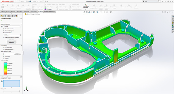

SOLIDWORKS Wall Thickness Analysis
Proper wall thickness ensures proper material flow and helps avoid cosmetic defects link sink or warp.
Thickness Analysis
The next consideration helps ensure the material flows nice and evenly into the mold. For this to happen, we want as close to constant wall thickness as possible. This can be especially challenging where we add bosses, clips, and ribs. To highlight any problem areas, we can call upon the Thickness Analysis in SOLIDWORKS. This is found on the Evaluate tab of the CommandManager but is also under the Tools drop-down menu.
Enter a value based on the overall thickness of the part (what you want the thickness to be). Choosing the Show Thin Regions will color code all the faces of the part thinner than that value. Thin walls means the flow of polymer is restricted and could cause a short shot. Choose the Show Thick Regions radio button and SOLIDWORKS will color code all faces thicker and thinner than the target value. Much like Draft Analysis, hovering the cursor over the model shows the thickness in that spot. If the walls are too thick, you could end up with sink marks or warpage.
Ideal thickness for injection-molded parts varies on material but can be anything from 0.5mm to 25mm, but most engineering plastics fit between approximately 1mm and 4mm.

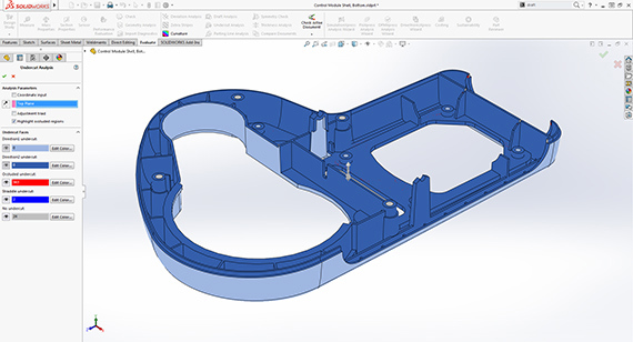

SOLIDWORKS Undercut Analysis Tool
In addition to identifying undercuts within your design, the Undercut Analysis tool can be used to explore various pull directions.
Undercut Analysis
The third check in SOLIDWORKS for injection molding is Undercut Analysis. More undercuts mean a more complex multipart tool rather than a simple two-piece tool. More complexity means more added expense and manufacturing time because of features like side-actions. Undercut Analysis is right beneath Draft Analysis and once again, select the pull direction for the option to use the adjustment triad if you haven’t explored all possibilities yet. To make it easier to see these undercut faces, you can toggle the display of each type of face by clicking the hide/show Eye icon next to each face type.
