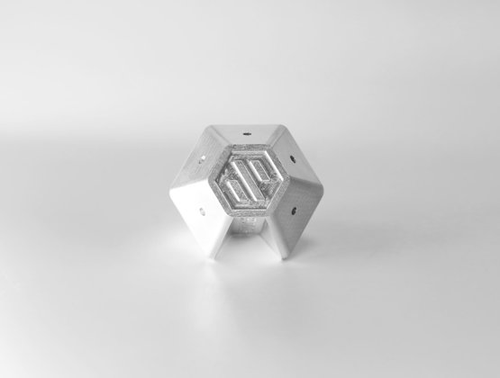

Aluminium 6082 - Hexagon
expand_moreSurface Finish: As Machined

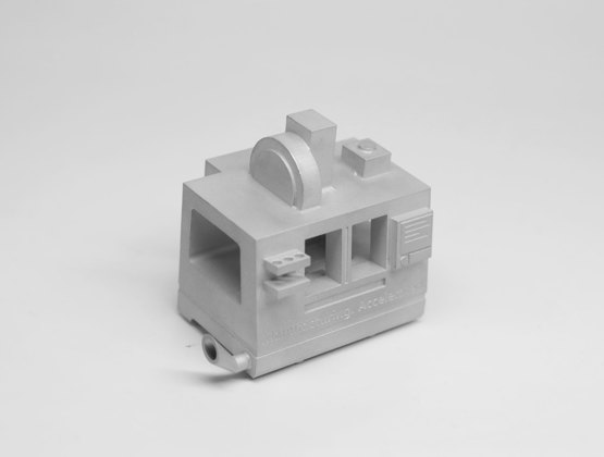

Aluminium 6082 - Mini CNC Machine
expand_moreSurface Finish: Bead Blasted

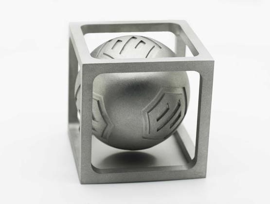

Aluminium 6082 - Ball in Cube
