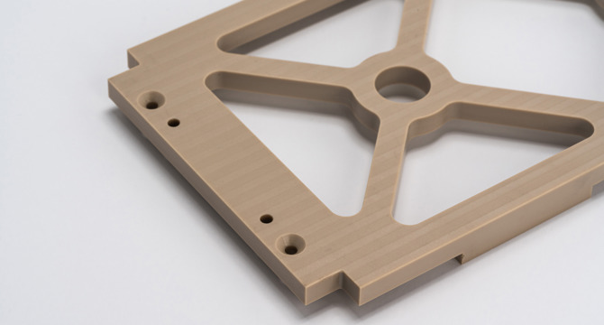

PEEK for CNC Machining
CNC machining is ideal for quick-turn prototyping and low-volume production using PEEK, especially for parts requiring tight tolerances and thermal stability.
Capability Details
Best for Prototypes and low-volume parts requiring high strength and heat resistance. Fast turnaround with excellent dimensional control
Tolerance Aligns with ISO 2768-medium unless otherwise specified
Wall thickness  Can accommodate thinner walls than injection molding depending on part geometry, though stiffness and machining constraints should be considered
Color options  Typically available in natural (beige) and black. Additional grades (filled PEEK) available on request
Surface finish As-machined finish, typically smooth to slightly matte depending on tooling and cutting parameters
Machining considerations  Higher tool wear and material cost compared to standard plastics; fixturing may be required for precision parts

CNC Machining with PEEK
CNC machining is best for quick-turn prototypes or low-volume PEEK parts that require high strength, heat resistance, and tight tolerances. It supports complex geometries and functional features, though the material’s stiffness and cost require careful design to optimize machinability and reduce waste.
Design Guidelines
  • Avoid unnecessary material removal. Efficient part geometry helps control cost
  • Use fillets and radii instead of sharp internal corners to improve tool life and reduce stress concentrations
  • Maintain consistent wall thickness for dimensional stability
  • Account for heat buildup during machining, especially in thicker sections
  • Plan for fixturing on complex or high-precision parts to maintain accuracy
