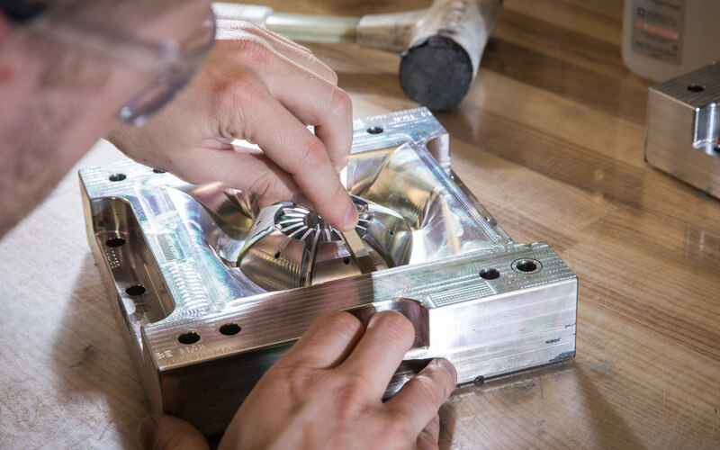

Low-Volume Production with Aluminum Tooling
Aluminum molds cost much less than steel tooling (tens of thousands of dollars less). They take less time to machine and are usable for 10,000 cycles or more (depending on material type and geometry). Because aluminum makes sense for lower volumes, it’s a great choice for bridge production, too.
Aluminum—as a softer metal—is more easily machined than steel. That means that when that block of metal is milled, it will take days instead of months to create what will become your tooling. You’ll save significantly on machining costs. So, if you are iterating your part, fine adjustments can be made more rapidly.
On a side note, if you go with aluminum, we charge no maintenance fees, and you get lifetime replacement if the mold is damaged. Also, if you move from prototyping quantities to on-demand production, you will receive the value of your aluminum mold as a discount on your production quantity order.
