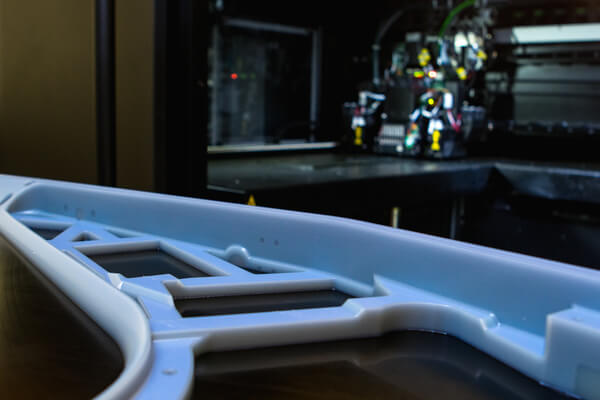

The materials available to 3D printing part designers behave differently both during and after the printing process. For instance, SLA (stereolithography) provides fine finishes and high accuracy, but the ABS- and PC-like resins used here undergo slight shrinkage during the UV curing process. So do the nylon materials used in SLS (selective laser sintering) and MJF (Multi Jet Fusion), which shrink a bit as the parts cool.
On the other hand, metal parts made with DMLS (direct metal laser sintering) experience a small amount of thermal expansion throughout the build and during the subsequent heat treatment, both of which can affect final dimensions. In each case, our build prep team applies global offsets to accommodate these material-specific behaviors, ensuring that finished parts fall within specified tolerances regardless of the material selected.

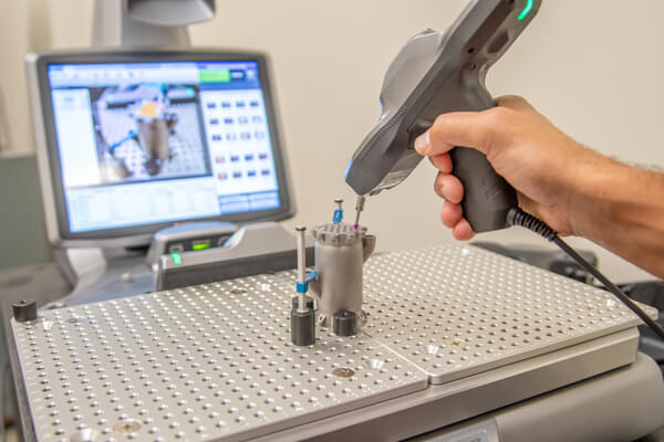

Whatever process or material was used to make them, all 3D-printed parts undergo inspection before shipping. Our standard quality control process requires visual and dimensional checks using calipers and gaging as needed to verify that parts meet dimensional tolerances and are free from physical defects. For those requiring a higher quality level, additional services are available. These include:
- First Article Inspection (FAI)
- CMM (coordinate measuring machine) measurements
- Laser scanning and 3D scanning reports
- X-ray and CT scanning (particularly valuable for DMLS parts)
- Material and process certification reports for compliance with ISO and AS9100 standards
