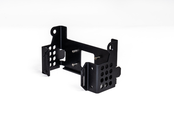

Design for sheet metal is quite different than design for other manufacturing processes. For one, you’re starting from a flat slab of metal which must be bent, punched, or laser cut into very specific shapes. Always remember that single sheet idea and how bends in one area can have a profound effect on manufacturability, and ultimately, the success of the enclosure. Here are some things to think about when designing sheet metal enclosures.
Form and Fit
One of the trickiest factors of the prototyping process is ensuring your design fits together and can be assembled. Small errors like forgetting a clearance hole for tooling to access a fastener or designing components to mate face-to-face in a bent corner, can add substantial cost and time to your project, as you have to move back to the design phase to fix these errors and remanufacture the next revision.
Tooling access is important because ultimately, a collection of standalone parts does nothing for you if they can’t be assembled into their final form. If you can’t get a screwdriver into a corner to torque your fasteners during assembly, you aren’t going to make much headway towards a final product. Besides fitting a tool into a tight place, it is imperative that your design includes a hole in both components to be fastened. In a fast-paced environment this is an easy mistake to make and it brings an iteration to a grinding halt.

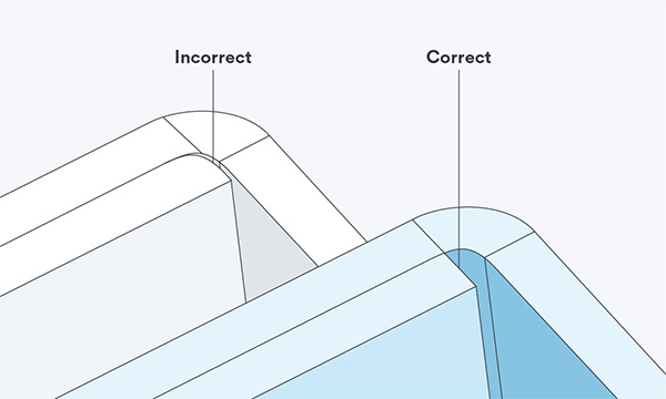

Many designers who aren’t well-versed in sheet metal will forget that formed corners will have a radius. Engineers have designed parts that mate face-to-face and when the design is turned into sheet metal and a bend radius is added—0.030 in. (0.76mm) inside bend radius is most common—the components that are mated run into an interference in the bend region. A best practice is to add inside bend radii to your parts as you design them and plan your mating components to meet and secure before the bend region.

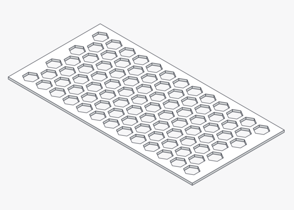

Enclosures for electronics get hot. The best way to mitigate that buildup of heat is through ventilation, whether the airflow is forced by using fans or naturally with open areas allowing heat to escape through convection. The need for ventilation has some significant effects on design and manufacturability. Perforations or louvers in your design create an open area that allows for air flow while preventing ingress of tools and fingers during handling and use. There are some options and alternatives you can consider when designing ventilation.
Perforation patterns are a graceful way of adding airflow to your enclosure. They are a pattern of holes, typically round or hexagonal, that are staggered and sized in a way that achieves an open area percentage that dictates the amount of flow. This is ideal for small areas of airflow as, once you start punching or lasering a large perforated area, there tends to be a significant amount of distortion added to the sheet. However, if you must incorporate a large perforation pattern there are two ways you can minimize or eliminate the sheet distortion.
  1. Consider a sheet of perforated material tack welded into your enclosure. Perorated material is punched stock that has been flattened by the mill or vendor. This route includes a touch of welding and adds the cost of extra material but virtually eliminates the deformation concern.
  2. Use the smallest possible open area percentage that serves your airflow needs. This method may not eliminate the possibility of distortion but it will go very far to minimize it.

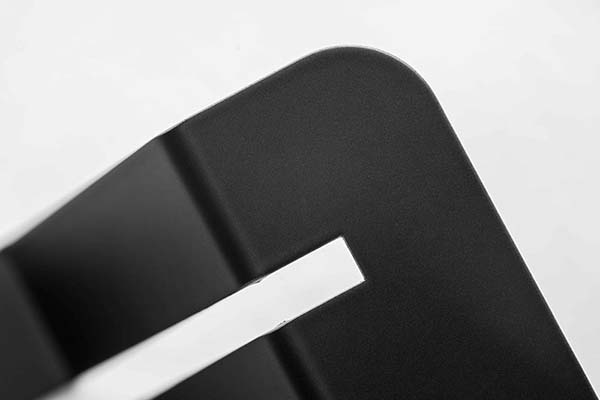

Bend Radius
Sheet metal is bent using a press brake which uses tons of weight to bend your chosen materials. A punch, which looks like a pointy tip, works in conjunction with a die. The punch lowers down onto the metal workpiece, which sits atop the die and is then deformed by the tons of weight as it’s pressed into the die. The bend is never a perfect, sharp angle. Instead, the punch/die combination adds a slight curvature called a bend radius, both on the inside and outside of your material. You can choose how large the bend radius is in your designs, but you do need to compensate for this in your designs. For example, if you want a component to fit into that bend, match the component’s external bend radius to the internal bend radius of the chassis to ensure a good fit. Note that external radii are inextricably linked to the material being bent and its thickness.
Formability Considerations
This goes back to the basic premise of sheet metal fabrication. You are bending a single sheet of metal. For example, while the top of a cardboard box is made of a single sheet of cardboard, it has material cut out of each corner area to facilitate bending of the flaps. Without that, the lid won’t work as intended. Or let’s say you want to create a flange in your workpiece. First, you’ll need to cut the flange material into a bendable form, but if you try to bend it at this point, you’ll likely deform the surrounding metal. To avoid that, you add bend relief, which is no more than a slight cut into the area of the flange where it meets the rest of the workpiece. With that in place, the bend will be successful, by avoiding deformation of the main area of the workpiece.
Bottom line: If you design your sheet metal part as a solid object, it’s important that you send us a CAD file that appears folded but shows where bends should go to ensure manufacturability.

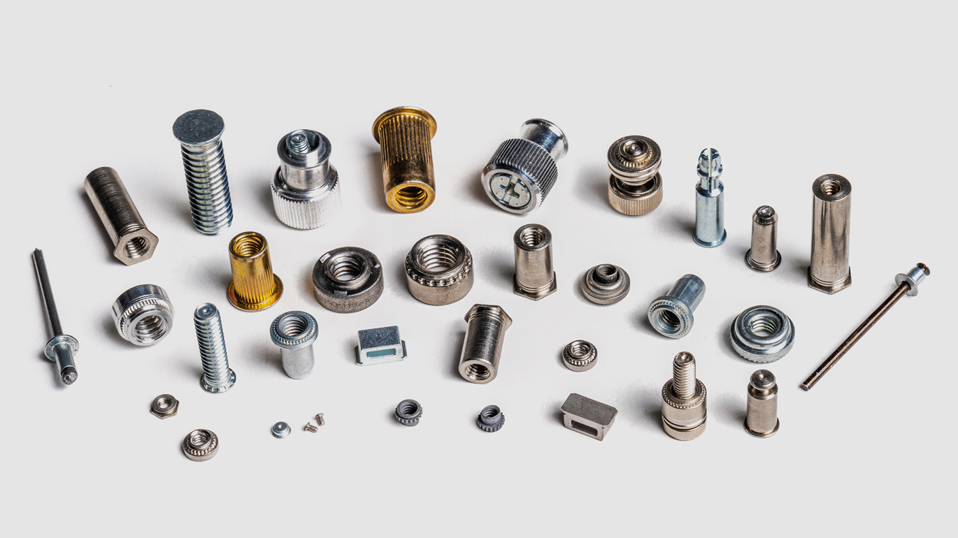

Hardware
Panel fasteners and other types of PEM® hardware are used to bolster parts or provide threads for assembly. One thing to be aware of here is that, depending on the kind of plating the part will receive after fabrication, as well as the type of material it’s made of, the insert may need to be installed before or after any post-processing operation. This is one area where you definitely want to check with us before pushing the “accept” button.

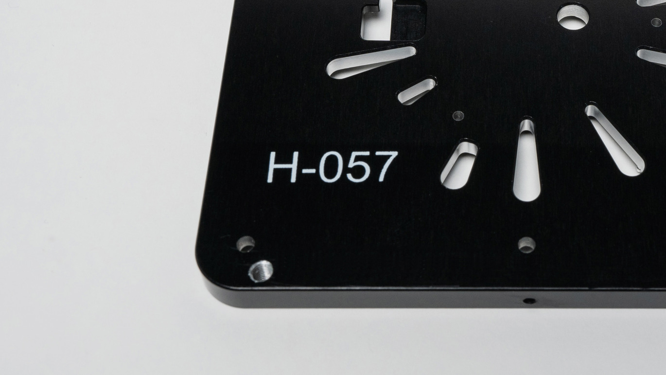

Part Marking
Part marking can be done with epoxy ink and stencil using a stencil font, or it can be done with a variety of laser marking methods. Engraving, which removes material to create a deep permanent mark, marking, which transforms the surface to produce a white or black mark, and finally etching, which ablates a small amount of plating to produce a white mark.
