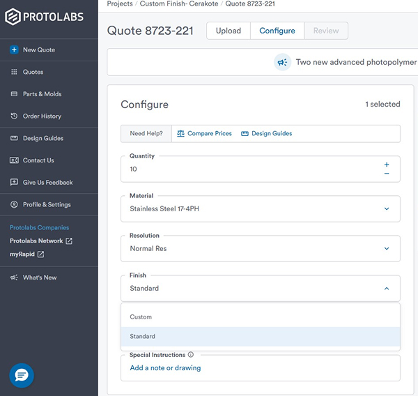

Step 1: In your quote configuration, select "custom" from the finish drop-down menu. From here you will be prompted to describe what type of finish you are looking for. This is where you will identify the coating selection from the available options.

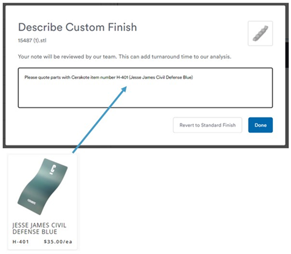

Step 2: Please provide a detailed description of the Cerakote series and color you'd like applied to your parts for our applications engineer to review.

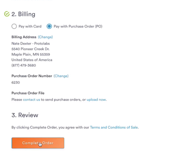

Step 3: You will receive a link that will bring you to a final quote that includes the custom finishing required. Place your order and wait for your custom finished parts to arrive!
