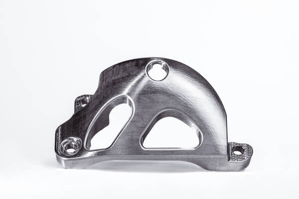

Aluminum Component Machined for the Harley-Davidson Factory Racing Team

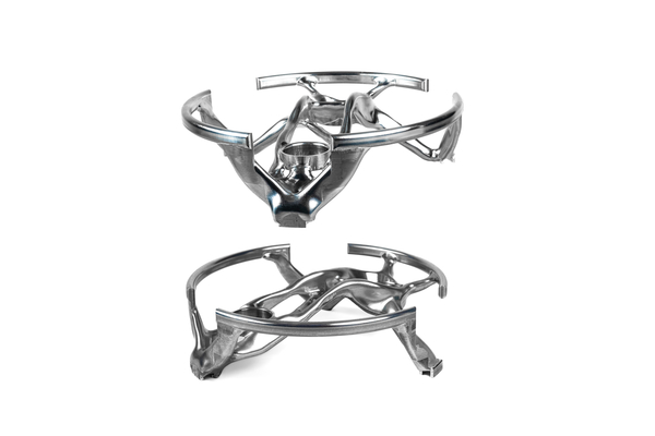

Aluminum Parts for the NASA Goddard Space Flight Center Machined and Delivered in 36 Hours

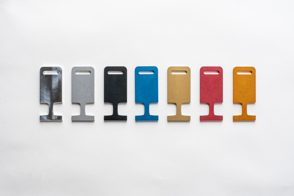

Anodizing is one of the most common finishing options, offering strong corrosion protection and enhancing the overall appearance of metal parts. Three types of aluminum anodizing are available from Protolabs:
  • Chromic Acid (Type I): Provides a whisper-thin but still durable coating. Commonly used for welded parts and assemblies, and as a primer before painting. Like all anodized surfaces, it is non-conductive.
  • Sulfuric Acid (Type II): Harder than Type I, it offers an exceedingly durable finish. Usage examples include carabiner hooks, flashlight handles, motorcycle parts, and hydraulic valve bodies.
  • Hard Anodize or Hardcoat (Type III): This is the thickest and hardest anodize available and it has a wide range of applications for parts and products in automotive, aerospace, heavy equipment, marine, general manufacturing, and defense industries.
Another option is plating, which electrically bonds protective elements to the aluminum. Plating is available only through Protolabs Network or when you order complete prototype parts. Adding plating often means adding lead time, so keep that in mind. Also note that plating is one of the more expensive finishing options. Here’s what’s available:
Type of Plating Added Lead Time
Anodizing Clear anodize Type II Class 1 None
Black anodize Type II Class 2 None
Red anodize Type II Class 2  2 days
Blue anodize Type II Class 2 2 days
Clear Chromate Type II Class 1A none
Type II Class 3 none
Yellow Chromate Type II Class 1A none
Type III 2 days
Nickel Class 1 3 days
Zinc Clear and yellow 3 days
Titanium anodizing n/a 3days
Powder coating n/a 5 days
Black oxide n/a 5 days
For a tough, aesthetic finish, you can choose an application of powder coating on your parts. It leaves a somewhat protective layer of polymer-based colored powder.
