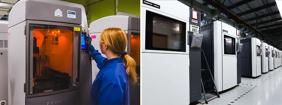

An engineer tends to an SLA printer (left). A group of FDM printers hard at work (right)
