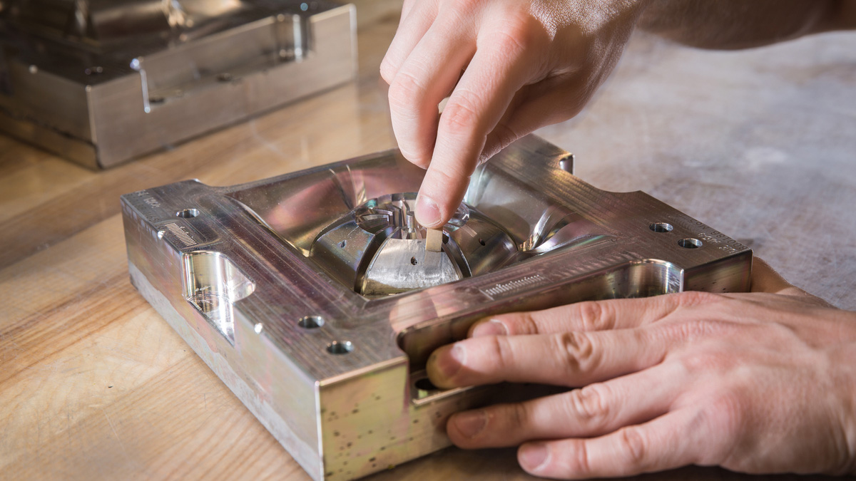

What is Soft Tooling?
Soft tooling uses aluminum molds to produce injection molded plastic parts. Aluminum is easier and faster to machine than steel, making it well suited to prototypes, bridge tooling, and low- to medium-volume production.
Because aluminum molds can be manufactured more quickly, they offer shorter lead times and lower upfront tooling costs. This is a benefit for validating designs, testing product demand, or scaling to production sooner while minimizing investment.
Modern aluminum tooling is capable of producing high-quality production parts with excellent dimensional accuracy and consistent surface finishes. Although it does not match the lifespan of steel tooling, it is often the most economical choice for projects producing thousands, or even tens of thousands, of parts. Protolabs offers aluminum tooling in-house for time-sensitive projects. Learn more about our injection molding services.
