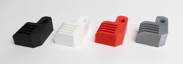

Unfilled Nylons
Offering an excellent balance of strength, durability, chemical resistance, and dimensional stability, PA12 (Nylon 12) is among the most widely used of SLS materials. We offer three grades of PA12—White, Black, and Value. The latter of these is appropriately named; made from partially recycled powder, it sacrifices some of the bright white color of PA12 White (PA650) but makes up for it by being the lowest cost SLS material option. Parts made from PA12 Black achieve their color from post-print dyeing.
Regardless of its color, PA12 is a versatile, engineering-grade nylon widely used in SLS 3D printing due to its excellent balance of strength, durability, chemical resistance, and dimensional stability. It produces parts that are tough yet lightweight, making it a go-to material for functional prototypes and end-use components across many automotive, medical, industrial, and consumer applications.
Unlike PA12 Black (in which parts are dyed that color after printing), PA11 Black (PA850) is pre-pigmented at the powder level, resulting in a consistent black color straight from the printer. Derived from castor oil (and not petroleum, as with PA12 and, indeed, most nylons), it is bio-based. This quality tends to make it the first choice for orthotics and wearables, for which flexibility, biocompatibility, and sustainability are key. It's also more ductile and impact-resistant than PA12, making it a better choice for flexible, load-bearing, or bio-based applications like custom medical devices or living hinges.
Material Properties of Unfilled Nylons
| Tensile Strength | E-Module | Heat Deflection | Elongation | |
| PA12 Black | 46 MPa | 1,900 MPa | 175°C | 13% |
| PA12 White | 50 MPa | 2,000 MPa | 177°C | 11% |
| PA12 Value | 46 MPa | 1,900 MPa | 190°C | 13% |
| PA11 Black | 52 MPa | 1,800 MPa | 188°C | 30% |

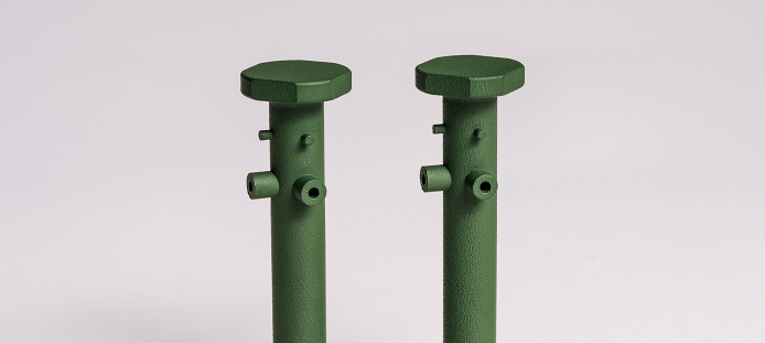

Dyeing and painting are also possible. As suggested earlier, parts made of PA12 White can be dyed blue, green, red, yellow, and black, although as the design tip just mentioned states, “additional color options—like orange or purple—can be supported but they are not included in our standard offering, so it will be more expensive as they are mixed on a per-order basis.”
Finally, Protolabs now offers a ceramic-filled spray coating called Cerakote. Originally from the firearms industry and popular on custom-finished handguns and rifles, Cerakote is applied to parts after printing and then cured during a baking process. It is an incredibly versatile finish that is resistant to scratches, heat, and many chemicals, making it a great choice for both functional and cosmetic applications.
