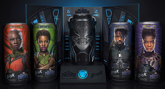

In anticipation of the “Black Panther” movie premiere, the two companies partnered to develop a limited-edition kit featuring several new technologies and manufacturing processes, including 3D printing services from Protolabs. The kit contained five cans representing each of the movie’s main characters, a Samsung tablet, comic books, behind-the-scenes photos, a light up carton with HiLight smart LEDs, and a 3D-printed Black Panther mask that fit onto the corresponding can.

Black Panther mask covering for water cans

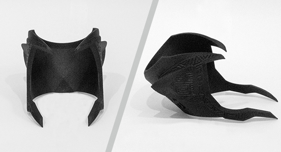

Given the mask’s high level of detail, PepsiCo turned to 3D printing for its design freedom. During development, the team of engineers evaluated five production-grade 3D printing technologies.

After evaluating the physical prototypes produced by three 3D printing technologies, the team chose to move forward with MJF due to its low cost, surface finish quality, and resolution, which precisely replicated the fine features in the mask design.

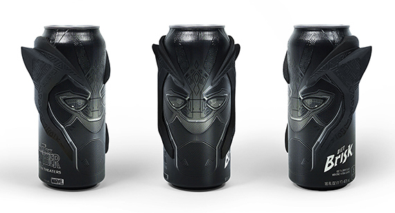

Black Panther 3D printed water can
Multi Jet Fusion was chosen for the final part as it had the precision necessary to replicate the mask’s fine features and a deep black color that would last for several years.
“When we received the Multi Jet Fusion part it was clear that this technology was going to meet the cosmetic requirements we outlined at the beginning of the design process,” said Phinney. “Not only did the part look great, but it was also the most affordable process among the final three technologies we considered.”

With final parts in hand, the promotional kit was assembled and put through the company’s distribution testing to ensure it could withstand the rigors of shipping. After a series of vibration and compression tests as well as drops, they found the mask remained secured on the can and were assured the kit would arrive in its intended configuration.
