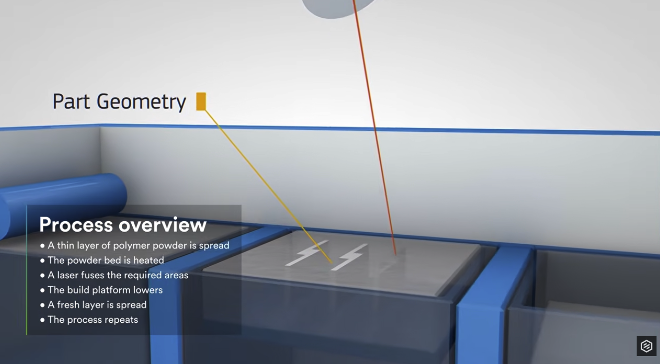

How does SLS 3D printing work?
Here's a high-level overview of the process.
A thin layer of polymer powder is spread across the build area. The powder bed is heated to just below the material's melting point. A laser scans the cross-section of the part and fuses the required areas. The build platform lowers slightly. A fresh layer of powder is spread. The process repeats until the entire part is complete.
After printing, the build needs to cool down before the parts are removed from the powder bed and cleaned.
One of the most important things to understand about SLS is that the loose powder around the part acts as a natural support material during the build. This means SLS usually does not need separate support structures in the way other 3D printing technologies often do.
And this opens up many possibilities. SLS is especially good for features such as internal channels, lattice structures, snap fits, living hinges, and nested or interlocking parts.
This balance of complexity and efficiency is a key reason why SLS is so widely used in professional manufacturing.

How Does SLS 3D Printing Work?
SLS 3D printing works by spreading a thin layer of polymer powder across a build platform. A laser then scans the shape of the part into the powder layer, fusing the required areas together. Once one layer is complete, the build platform lowers slightly, a new layer of powder is spread, and the process repeats.
This continues until the full 3D printed part is complete.
The SLS process typically follows these steps:
  1. A thin layer of polymer powder is spread across the build area.
  2. The powder bed is heated to just below the material’s melting point.
  3. A laser scans the cross-section of the part and fuses the required areas.
  4. The build platform lowers slightly.
  5. A fresh layer of powder is spread over the previous layer.
  6. The process repeats until the full part is built.
After printing, the full build needs to cool before the parts can be removed from the powder bed. The parts are then cleaned to remove any remaining unsintered powder.
One of the most important benefits of SLS is that the loose powder surrounding the part acts as a natural support material during printing. This means SLS usually does not need separate support structures.
Because of this, SLS is well suited for complex features such as:
  • Internal channels
  • Lattice structures
  • Snap fits
  • Living hinges
  • Nested or interlocking parts
 This combination of complexity, strength, and production efficiency is one significant reason as to why SLS is so widely used in professional manufacturing.
