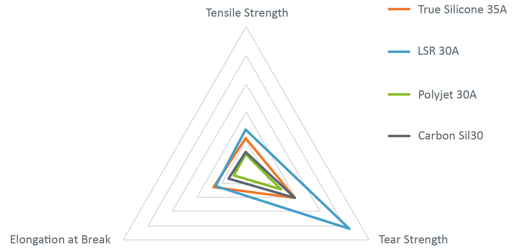

Compare Material Properties at 30A Hardness

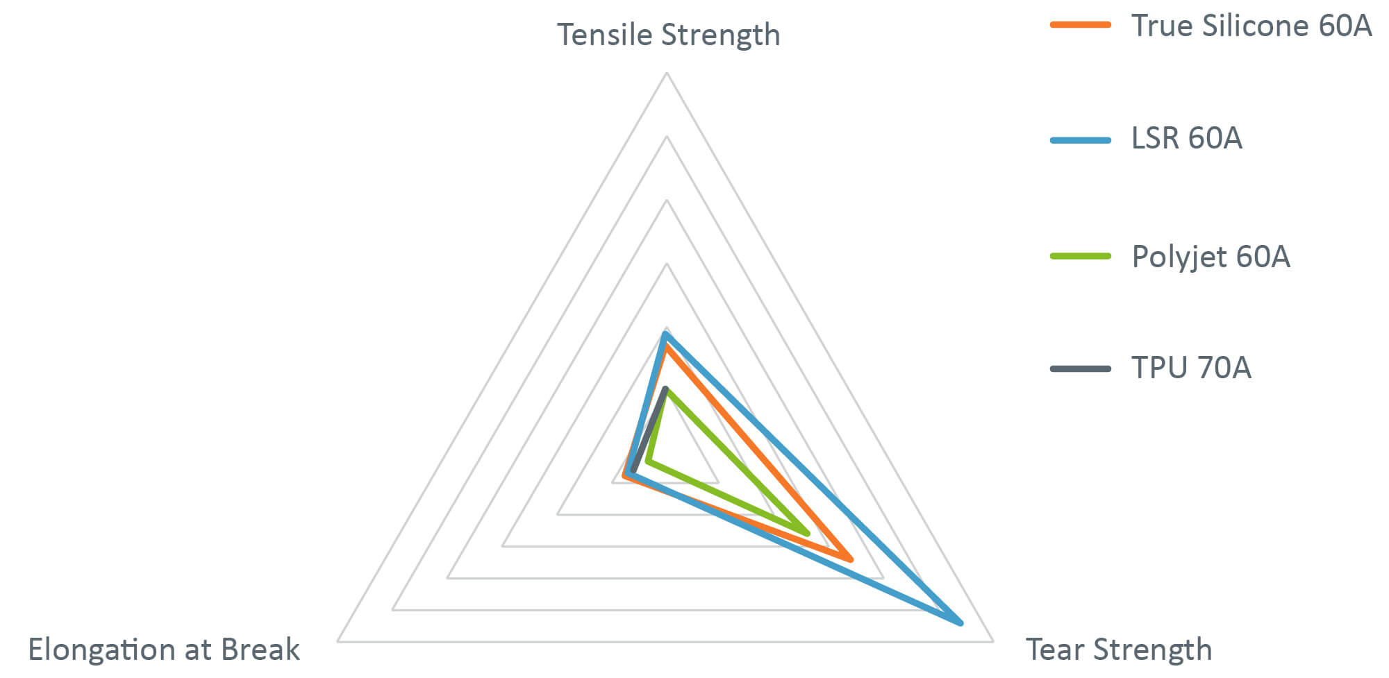

Compare Material Properties at 60A Hardness
